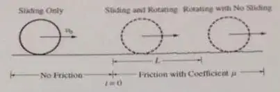

The definition of the scenario was:
Diagram of situation
A ring of mass $M$, radius $R$, and rotational inertia $MR^2$ is initially sliding on a frictionless surface at a constant velocity $v_0$ to the right. At time $t = 0$ it encounters a surface with coefficient of friction $\mu$ and begins sliding and rotating. After traveling a distance $L$, the ring begins rolling without sliding.

The force due to sliding friction causes the center of mass to decelerate - since it is the only external force acting on the ring, and we know the center of mass moves as though all forces act there. You might find this earlier answer of mine and the links therein helpful.
