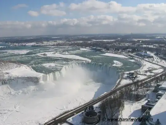

Here is a picture of the usual vigorous Niagara Falls (in the winter). enter image description here

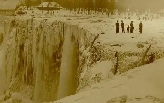

Here is the picture of Niagara Falls frozen in 1933 (in the very cold winter). Niagara Falls frozen in 1933

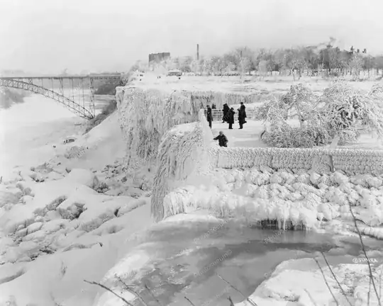

Here is the picture of Niagara Falls frozen in 1911 (in the extremely cold winter). enter image description here

consider the conditions of nearly completely frozen falls: which means there are water branches from the very top of the falls are frozen connected to the bottom of the falls.
The picture you shown suggests the stuffs connecting from top of waterfall to the bottom is icicle, which can only be formed with not so fast flowing of water, otherwise high speed water flow can melt the icicle.
