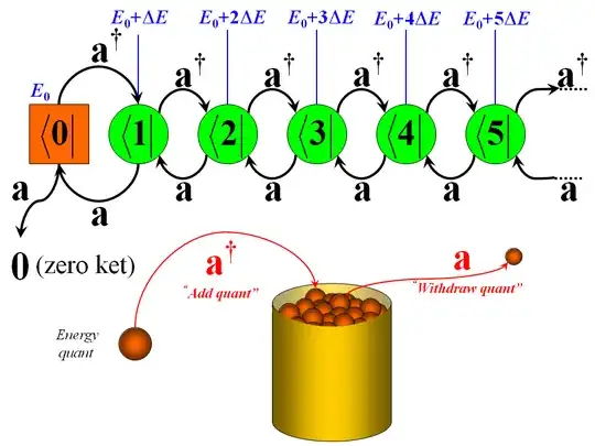

$$a = \left(\begin{array}{ccccc}0&\sqrt{1}&0&0&\cdots\\0&0&\sqrt{2}&0&\cdots\\0&0&0&\sqrt{3}&\cdots\\\cdots&\cdots&\cdots&\cdots&\cdots\end{array}\right)\qquad(8)$$
and its Hermitian conjugate as the wonted ladder operators. They drop out of this analysis quite naturally and can be thought of as "prototypical" normalised versions of the "stripe" matrices $\tilde{X}$ and $\tilde{P}$ in (7) that we need to build the Hermitian observables $\hat{X}$ and $\hat{P}$ with. The general family of observable pairs in (7) reduces to the wonted position and momentum observables when $\xi=\chi=0$. Notice that the requirement for the cannonical commutation relationship forces all the frequencies in (1) to be present and observable - there can be no gaps of $n\,\omega_0$ for $n>1$ and there must be infinitely many of them. The CCR cannot be realised by finite matrices since the left hand side $[\hat{X},\,\hat{P}]$, being a Lie bracket between matrices, would needfully have a trace of nought for finite square matrices, which cannot be true for the right hand side $i\,\hbar\,I$. This simple point was first heeded by Hermann Weyl.

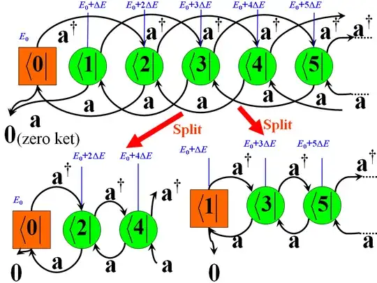

For the other cases of observables whose infinite, striped matrices have two diagonal stripes that are $N$ stripes above and below the leading diagonal, the analysis is essentially the same as above: what happens in these cases is that one finds that $\mathcal{H}$ is sundered into $N$ subspaces which are each invariant under the observables $\hat{H},\,\hat{X},\,\hat{P}$ and which each behave under the action of these observables the same as in the original definition, aside from that the minimum energy spacing is now $N\,\omega_0$. In other words, we now have $N$ uncoupled quantum simple harmonic oscillator systems, each with $N$ times the original energy spacing: the ground, $N^{th}$, $2\,N^{th}$, $3\,N^{th} \cdots$ energy eigen states and no others are closed under any the action of any member of the algebra $\mathbf{A}$ of operators generated by $\hat{H}, \,\hat{X},\,\hat{P}$. These states form our first quantum subspace that behaves like a quantum harmonic oscillator with energy spacing $N\,\hbar\,\omega_0$. Likewise, the first, $(N+1)^{th}$, $(2\,N+1)^{th}$, $(3\,N+1)^{th} \cdots$ energy eigen states and no others are closed under any member of $\mathbf{A}$. These form the second quantum state subspace and our second quantum harmonic oscillator. And so on: there are $N$ such subspaces where the $j^{th}$ such subspace is that spanned by energy eigenstates $j,\,N+j,\,2N+j,\,\cdots$. This splitting of the quantum subspaces is drawn figuratively below, which shows first the case just studied where the stripes are straight above and below the leading doagonal:
Infinite ladder quantum harmonic oscillator system
and now what happens when the striped matrices have their nonzero stripes two stripes above and two stripes below the leading diagonal:
Splitting a simple quantum harmonic oscillator system into two subspaces when stripes are two notches above and below the leading diagonal
So these cases with stripes $N$ stripes above and below the leading diagonal give us essentially nothing new: we always get a quantum harmonic oscillator with Hamiltonian of the form (1) and canonically commuting observables of the form (7), for some value of even energy spacing $\hbar\, \omega$ and ground state energy.
We can complete the picture by deriving from (1) the Hamiltonian matrix in terms of this ladder operator $a$ and its conjugate $a^\dagger$:
$$\hat{H} = E_0 I + \hbar\,\omega_0\, a^\dagger\,a\qquad(9)$$
So we see that the ladder operators arise quite naturally along the way when begining with our original definition and working backwards towards the original quantum harmonic oscillator problem of the 1920s. Indeed, once we have constructed a general pair of observables as in (7) which fulfill the canonical commutation relationships, one can quite straighforwardly show that operators with the matrices given in (7) must have continuous spectrums. So, if we change our co-ordinates so that we work in position co-ordinates, i.e. where the $\hat{X}$ in (7) becomes the diagonal (multiplication) operator $\hat{X}f(x) = x f(x)$ for $f(x)\in \mathcal{H} = \mathbf{L}^2(\mathbb{R}^3)$, then we can argue as I do in my answer here that there is needfully such a co-ordinate system wherein $\hat{X}f(x) = x f(x)$ and $\hat{P} f(x) = -i\,\hbar\,\nabla f(x)$. So now, from (9), the Hamiltonian in these co-ordinates is:
