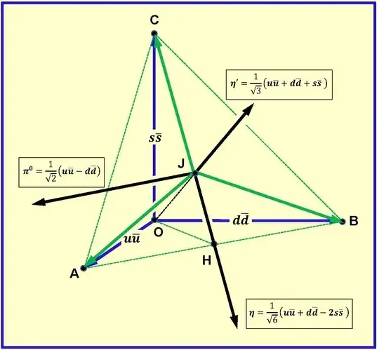

The quark structure of $\:\boldsymbol{\eta}^{\prime}\:$,$\:\boldsymbol{\eta}\:$ and $\:\boldsymbol{\pi}^{0}\:$  mesons
FIGURE : The quark structure of $\:\boldsymbol{\eta}^{\prime}\:$,$\:\boldsymbol{\eta}\:$ and $\:\boldsymbol{\pi}^{0}\:$ mesons
(Note: Meson symbols $\:\boldsymbol{\eta}^{\prime}\:$ and $\:\boldsymbol{\eta}\:$ must not be confused with the complex 3-vectors in the text)
(1) Meson $\:\boldsymbol{\eta}^{\prime}\:$ is a singlet, representative of $\:\boldsymbol{1}\:$ in $\:\boldsymbol{3}\boldsymbol{\otimes}\overline{\boldsymbol{3}}=\boldsymbol{8}\boldsymbol{\oplus}\boldsymbol{1}\:$
(2) Mesons $\:\boldsymbol{\eta}\:$ and $\:\boldsymbol{\pi}^{0}\:$ are members of the octet $\;\boldsymbol{\lbrace}\boldsymbol{\pi}^{+},\boldsymbol{\pi}^{-},\boldsymbol{\pi}^{0},\mathbf{K}^{+},\mathbf{K}^{-},\mathbf{K}^{0},\overline{\mathbf{K}}^{0},\boldsymbol{\eta}\boldsymbol{\rbrace}\;$, basic meson states of $\boldsymbol{8}\:$ in $\:\boldsymbol{3}\boldsymbol{\otimes}\overline{\boldsymbol{3}}=\boldsymbol{8}\boldsymbol{\oplus}\boldsymbol{1}\:$ where
$\:\boldsymbol{\pi}^{+}\equiv\boldsymbol{u}\overline{\boldsymbol{d}}\:$ , $\:\boldsymbol{\pi}^{-}\equiv\boldsymbol{d}\overline{\boldsymbol{u}}\:$ , $\:\mathbf{K}^{+}\equiv\boldsymbol{u}\overline{\boldsymbol{s}}\:$ , $\:\mathbf{K}^{-}\equiv\boldsymbol{s}\overline{\boldsymbol{u}}\:$ , $\:\mathbf{K}^{0}\equiv\boldsymbol{d}\overline{\boldsymbol{s}}\:$ , $\:\overline{\mathbf{K}}^{0}\equiv\boldsymbol{s}\overline{\boldsymbol{d}}\:$ .
$\:\mathbf{Q}\boldsymbol{\otimes}\overline{\mathbf{Q}}=\boldsymbol{\lbrace}\boldsymbol{\pi}^{+},\boldsymbol{\pi}^{-},\boldsymbol{\pi}^{0},\mathbf{K}^{+},\mathbf{K}^{-},\mathbf{K}^{0},\overline{\mathbf{K}}^{0},\boldsymbol{\eta}\boldsymbol{\rbrace}\boldsymbol{\oplus}\boldsymbol{\lbrace}\boldsymbol{\eta}^{\prime}\boldsymbol{\rbrace}\:$
