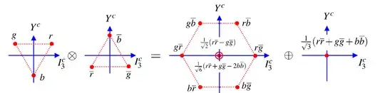

  • Colour basis:
red : $r = (1,0,0)$, green: $g = (0,1,0)$ and blue: $b = (0,0,1)$.
Let's take the product between a generic colour and anti-colour vector:
$$ \mathbf{3} \otimes \bar{\mathbf{3}} = \mathbf{8} \oplus \mathbf{1}, $$
which means you can decompose the representation of the LHS into two independent bits. Leaving aside all the group theory related maths, physically you interpret this as $8$ gluons and the $1$ colour singlet discussed in 2a.
And you can draw these pretty "Eightfold way" diagrams (source):

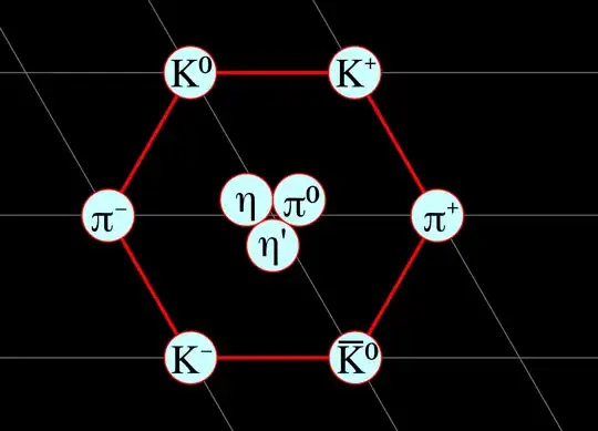

  • Quark basis:
up $u = (1,0,0)$, down $d = (0,1,0)$ and strange: $s = (0,0,1)$.
Again, let's take the product between a generic quark and anti-quark vector:
which we interpret as the $\boldsymbol{\eta}'$ meson singlet, and the $\;\boldsymbol{\lbrace}\boldsymbol{\pi}^{+},\boldsymbol{\pi}^{-},\boldsymbol{\pi}^{0},\mathbf{K}^{+},\mathbf{K}^{-},\mathbf{K}^{0},\overline{\mathbf{K}}^{0},\boldsymbol{\eta}\boldsymbol{\rbrace}\;$ octet (see here for maths).
Depending on which basis you choose, i.e. on what $\mathbf{3}$ corresponds to physically, it could be a meson, a yet-experimentally-not-discovered gluon etc.
