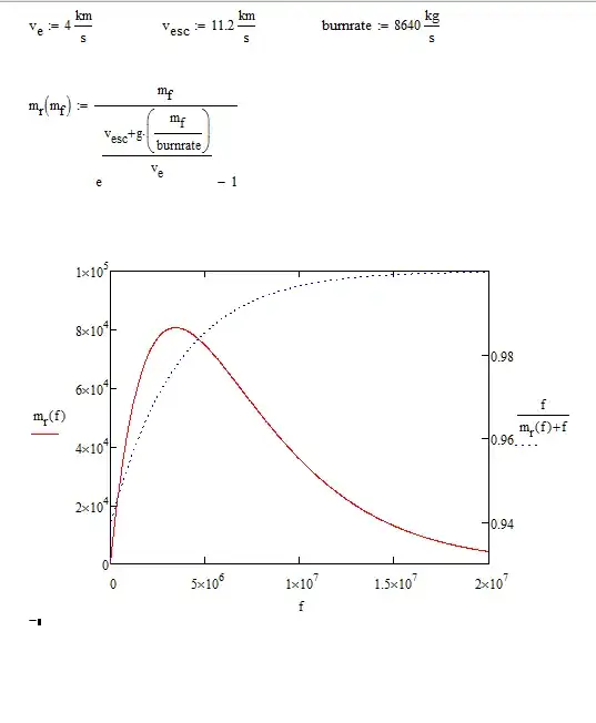

Note that this is effectively providing $m_r$ as a function of $m_f$, since all the other parameters are fixed by the constraints of the mission and equipment as well as environmental constants. Since the relationship isn't immediately obvious, here is a plot of $m_r$ against $m_f$ for selected values of the constants:
In red, we have a plot of rocket mass versus initial fuel mass, while in blue we have a plot of the ratio of initial fuel mass to total mass. Note that the axis for the blue plot starts at 0.9!! This indicates that regardless of what rocket mass you picked, the net initial mass of your vehicle would have to consist almost entirely of fuel.

Upper limit on payload:
A very interesting thing happens near the inflection point of the rocket mass - fuel mass curve. Before the inflection point, adding more fuel allowed us to hoist a larger payload to the desired velocity.
However, somewhere around $4 \cdot 10^6$ kg of fuel mass (for our selected parameter values) we discover that adding more fuel starts to decrease the payload that can be hoisted! What is happening here is that the cost of the additional fuel having to fight against gravity begins to win out against the benefit of having a high fuel to payload mass ratio.
This shows there is a theoretical upper limit to the payload that can be hoisted on Earth using the propellant technology we have available. It is not possible to simply keep increasing the payload and fuel masses in equal proportion in order to lift arbitrarily large loads, as would be suggested by using the Tsiolkovsky equation with no extra terms for gravity.
