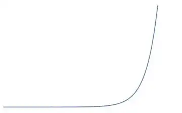

The basic question is how the speed of a rocket change. Since you are always expelling mass at a fixed velocity, with a given momentum, you must also gain that momentum yourself, so that it is conserved. Now assume that by some reason, even though you are expelling mass, your mass doesn't change. You are throwing mass with a fixed velocity, so your own velocity must increase proportionally ($v_{ex}$ dependence), but if you consider you are loosing mass as well, that velocity must increase even more to compensate for that. But how much is that "even more"? Proportionally to your own mass, you are loosing a higher percent of mass as time goes by, therefore your speed must increase faster as time goes by. So now there are a lot of functions that satisfy all that, but we need to make one more assumption: the larger your mass, the less the change in your mass matters, because it is proportionatelly very small.
So we need a function linear with $v_{ex}$, that increase faster and faster as we get closer to mass 0, but never gets negative (assymptote to the y axis), and changes little when the mass is really big. If you think about it, the exponential has those properties, but the other way around, it gets closer and closer to the x axis ($y=0$), without crossing it, and as y goes to infinity, the x value changes little.
Exponential
In order to get what we want we mirror it ($e^{-x}=y$) and then invert it ($x=ln(1/y)$):
enter image description here$$e^{-x}$$
enter image description here$ln(1/y)$
Here we have the $m^{-1}$ dependency, and the $m_0$ appears, so that when $m=m_0$ the velocity change is also $0$.
I don't know if that was clear, but I tried to give a completely intuitive approach to it. With no mathematical exactness.
