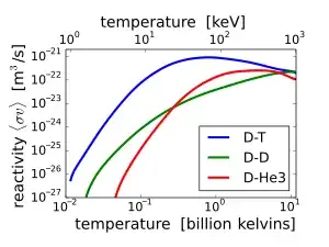

I agree with @john rennie, but I think it's worth noting that reaction rates for D-T are higher at a lower temperature as compared to D-D:
Higher temperatures present many difficult engineering challenges (even more so than the still high temperatures for D-T reactions).
