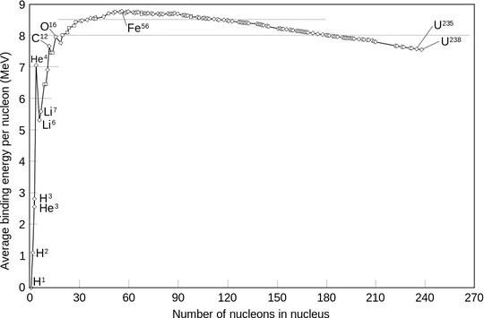

Nuclear Binding Energies
Image Source: Wikipedia Nuclear Binding Energies
On this chart, you can get some idea of the forces we would have to overcome to utilise other elements in fusion reactions, and you might notice it flattens out at iron.
I would like to have a scientific answer why possibly any other material is not considering for fusion reactor? However, is there any theoretical possibilities of using other matter, e.g. using Hg?
With other elements, the ratio of energy in to energy out is much less, so they are not as efficient. In fact when you go up the periodic table as far as iron, you won't get any more out by fusing them together. That's part of the reason we are here today. Stars transmute elements, starting with hydrogen up as far as iron, then because there is no net energy output the star explodes from the pressure from gravity on the outside, which the star is incapable of resisting without having core energy emerging from fusion reactions.
