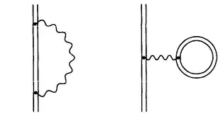

Using these solutions, the QED corrections to the atomic energy levels can be obtained from e.g. the Gell-Mann - Low (GML) formula, which relates the energy shift to $S$-matrix elements. In leading (one-loop) order, two $S$-matrix diagrams contribute, belonging to bound-electron self-energy (with a mass counterterm understood) and vacuum polarization:
The double lines correspond to the fermion propagator in the external Coulomb field of the nucleus. You can process these diagrams to a certain degree, but their exact evaluation can only be done numerically. If your system is predominantly non-relativistic (like the hydrogen atom), then you can start doing expansions in the binding parameter $Z\alpha$, and this will lead you to the ${\cal{O}}(m\alpha(Z\alpha)^4, \, m\alpha(Z\alpha)^4\ln(Z\alpha))$ textbook result for the Lamb shift (see e.g. Ch. 15 of The Theory of Photons and Electrons by Jauch & Rohrlich); the expectation value of the Uehling potential is a tiny part of this shift, originating from the second diagram. For strongly relativistic systems (hydrogen-like ions with large $Z$), you have no choice but to calculate the fully relativistic expressions numerically, but that is very difficult; see e.g. this review by Mohr, Plunien and Soff to get a taste, and for a discussion on the GML formula. If you already calculate everything fully numerically, than the assumption of a point-like nucleus is not that important, and you can incorporate some finite density model.
