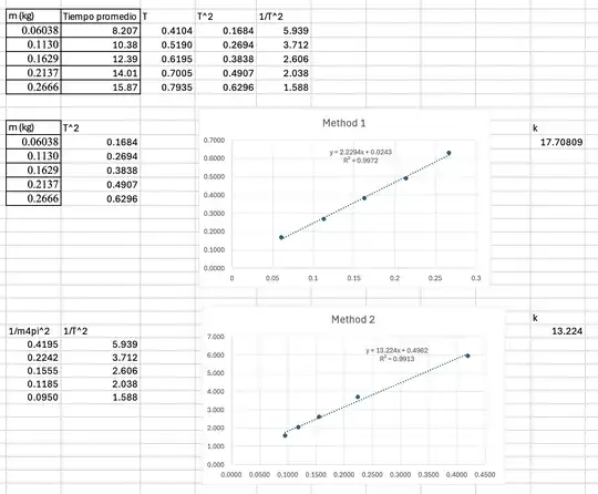

I am working on a physics practical involving coupled pendulums wherein I need to experimentally calculate the spring constant of a spring using the dynamic method. The dynamic method involves using Hookes law of $F=-kx$ and the SHM equation of $a=-ω^2x$ to get the relationship $T = 2π \sqrt{\frac{m}{k}}$.
The experiment involves timing 20 oscillations of a spring-mass system of varying masses. After obtaining the results of the period for each mass, I was left with graphing the results on Excel to calculate the spring constant.
At first, I used the equation $T^2 = \frac{4π^2}{k}m$, graphing $m$ with respect to $T^2$. The $k$ constant can be calculated by dividing the resulting gradient by $4π^2$; $k = \frac{4π^2}{\text{gradient}}$. Another method of calculating the spring constant was by using the equation $\frac{1}{T^2} = \frac{1}{4π^2m}k$, graphing $\frac{1}{4π^2m}$ with respect to $\frac{1}{T^2}$. The $k$ constant should be obtained by calculating the gradient of the resulting graph.
Unfortunately, when I tried each method separately, I found that the spring constant values were different, albeit only by 5 or so units. (The spring constant from the first method was 17.708 and the second method was 13.224)
My question is which method is more valid or accurate in calculating the spring constant?
Edit: Here is the data obtained from the experiment in the form of a pic

Well spotted, although I do not know why you thought of plotting $\frac 1{T^2}$ against $\frac{1}{4π^2m}$?
Although not necessary in this case, one way of looking at the data is to work out values of $4\pi^2m/T^2$ to look for outliers. Your data gives values of 14.2, 16.6, 16.8, 17.2, and 16.7. You might then think that the first data point, which might well be the least accurate, requires another measurement or a lesser weight when curve fitting. Looking at the method 2 graph, doesn't the rightmost data point seem to be an outlier?
However, in this example there is possibly a problem with the theory.
If $T = 2\pi\sqrt{\frac m k}$ then linearising the equation $T^2= \frac{4\pi^2}{k}\cdot m$ should yield a graph which goes through the origin. This is not the case for your data and this points to the need for amending your theory.
One of the assumptions made when deriving $T = 2\pi\sqrt{\frac m k}$ is that the spring has no mass. However, in your experimental data there is an indication that the mass of the spring cannot be ignored and the theoretical relationship then becomes $T = 2\pi\sqrt{\frac {m+m^*} {k}}$ where $m^*$ is called the effective mass of the spring and is approximately equal to a third of the mass of the spring.
This then means that there is only one simple way to linearise the equation,viz,
$$T^2= \frac{4\pi^2}{k}\cdot m+\frac{4\pi^2}{k}\cdot m^*$$ with a y-intercept of $\frac{4\pi^2}{k}\cdot m^*$ which is your method $1$.
Your method 2 does not lend itself to a simple linearisation.

One way to approach this is to consider the uncertainty in $T^2$ versus that in $T^{-2}$. When you find a line of best fit to the data with respect to either quantity you assume that errors for each data point follow the same normal distribution. However, your experiment measures $T$ rather than $T^2$ or $T^{-2}$ so it is more reasonable to assume that $T$ has this property than the other quantities you calculate from it. You could try finding a fit for $T$ against $\sqrt{m}$ instead (depending on the instructions for your practical). You should also fit a direct linear relationship ($y = mx$) rather than a general linear relationship ($y = mx + c$) because the former is the form of your equation.
I suspect that fitting against $T^{-2}$ will be more inaccurate. The measurements with smallest $T$ will have largest relative errors. Therefore those for large $T^{-2}$, where your data are sparser, are expected to be least accurate, potentially causing large errors in the estimated slope. The fact that there's a significant offset for your line of best fit in that case (when the vertical axis intercept should be 0) supports this conclusion.
FTT
  • 1,874
Use first method. Since second involves 3 multiplications, 1 division and a number squaring before plotting $x$. This results in the accumulation of floating point error in $x$ points, because more math operations reflects in more floating point rounding errors.
So to say,- in a second case you will get error range $\Delta x$ in $x$ chart axis points, since calculation errors propagates in any formulas. The more complex output formula- the bigger error-bar of chart variable is. First way does not have such drawback, since there's no calculation of $x$ values,- you simply put measured observable of mass.
Final conclusion,- for minimizing error sources in charts- it's almost always better to plot raw measurement values, unless there's a serious reason not to (can't evaluate the model otherwise, etc).
