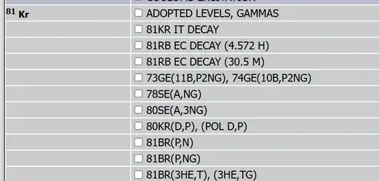

While summaries on various websites can provide a high level overview, if you want real details one should go to something like the Evaluated Nuclear Structure Data File (various mirrors around the world, including IAEA). If one goes there, enters 81 for the mass of interest, one sees:
81Kr listing in ENSDF

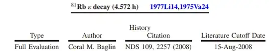

Note that the 81Rb decays are listed as EC (electron capture). Pulling up the first data (the 4.572 hour decay), the header is
81Rb data header
Already, one sees the listing is for $\epsilon$ decay. As noted in the NuDat 2 Glossary,
The greek letter epsilon (ε) is often used to indicate the combination of Electron Capture and β+ decay.

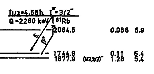

Diving further into the paper, looking at the top left corner of Figure 8, the level scheme for populating $^{81}$Kr from the decay, one sees:
81Kr level scheme closeup
That clearly shows that electron capture vs positron emission result in populating different states.
I conclude that there is no justification for declaring that the decay is exclusively positron emission. Electron capture is an observed path.
