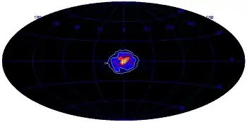

Astrophysicists have been looking at electron positron annihilations in the cosmos
electron postiron annihilation galaxy
The Universe viewed trough INTEGRAL: the first complete map of the sky at the electron-positron annihilation energy (Credits J. Knödlseder - CESR - September 2005).
If there existed regions in the sky where antimatter was aggregating, the interface between matter and antimatter areas should be shining with electron positron and other annihilation. Antiproton proton have been considered. Antiproton annihilation in the galaxy have also been considered in explaining the gamma spectrum from the galaxy .
In the space between galactic clusters if one of them were of antimatter, the interface would be a diffuse source of gammas from electron positron and antiproton annihilations to $\pi_0$ ( 1/3 of particles into which antiproton proton annihilate).
I do not know if a specific experiment has been looking for this but we would have certainly heard about something so exciting if it had been seen.
