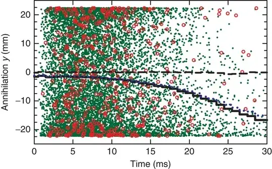

The Nature paper is dated January 2013 and includes this figure - the red circles are data - measured decays, while the green dots and both black line are simulations. Thus my question in March, 2016: "What is the Current Status of Measurement of the Gravitational Mass of Antimatter?"
Figure 2 from: "Description and first application of a new technique to measure the gravitational mass of antihydrogen" The ALPHA Collaboration & A. E. Charman, Nature Communications 4, Article number: 1785 doi:10.1038/ncomms2787

The current status of measurement can be found in the list of publications at the document server at CERN by requesting "antihydrogen gravitational mass" in the search. There are proposals with different methods but no announcement of a measurement.
The Aegis experiment is in no position to give any measurement yet so the status is still undefined. Here is their status report for 2014, published in 2015. One has to wait for the 2015 report.
The ALPHA results you show is the most recent announcement on the matter from them dated in 2013.

Today,(30 April 2013) the ALPHA Collaboration has published results in Nature Communications placing the first experimental limits on the ratio of the graviational and inertial masses of antihydrogen (the ratio is very close to one for hydrogen). We observed the times and positions at which 434 trapped antihydrogen atoms escaped our magnetic trap, and searched for the influence of a gravitational force. Based on our data, we can exclude the possibility that the gravitiational mass of antihydrogen is more than 110 times its inertial mass, or that it falls upwards with a gravitational mass more than 65 times its inertial mass.
Our results far from settle the question of antimatter gravity. But they open the way towards higher-precision measurments in the future, using the same technique, but more, and colder trapped antihydrogen atoms, and a better understanding of the systematic effects in our apparatus.
Note the number of antihydrogen used is 434.
From the dates of their last publications (2014) it seems they must be waiting for data, to be given antiproton beams, or working or recent runs.
