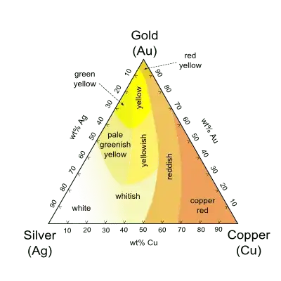

For a frame challenge, there actually are metals that are green and blue. For a green metal, an alloy of silver and gold is also sometimes called "green gold" and has a color described as green-yellow or greenish-yellow.
Image source: Wikipedia

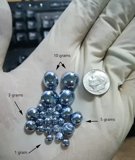

For a blue metal, there is osmium. On the photo, you can clearly see osmium's blue color in contrast to the coin's plain silver hue.
Source: luciteria.com

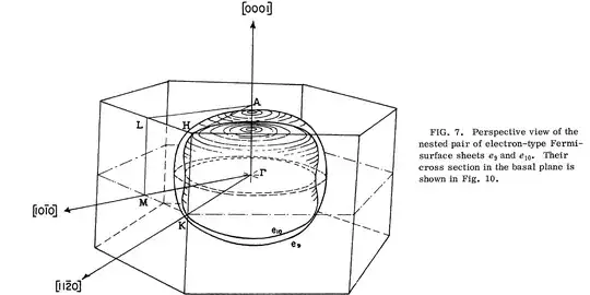

Now, what is happening with osmium? First, like beryllium, it turns out that there is both electron and hole contributions to the conductivity, each having separate Fermi surface. And, since osmium has way more electrons, the electronic structure is way more complicated. Fortunately, the Fermi surface has been measured (Kamm and Anderson, Phys Rev B 2(8) 2944 (1970)). Figure 7 from the paper shows the electron Fermi surfaces:
Yes, two surfaces, neither terribly spherical, nested one inside the other.

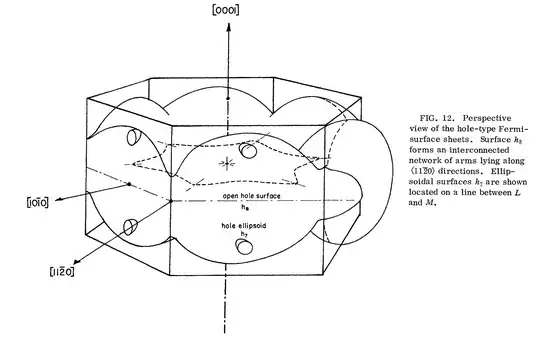

For completeness sake, Figure 12 is the hole Fermi surface:
But, why is osmium "blue". The answer lies in those nested electron Fermi surfaces. This structure allow interband transitions from one Fermi surface to the other, and it turns out that these occur primarily below the blue, leaving a strong impression of blue for the color. More on the optical response can be found in Nemoshkalenko et al., Sov. Phys. JETP 63(1) 115 (1986).
