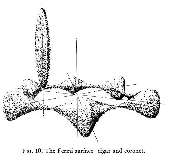

Of some interest might be Loucks and Cutler, Phys Rev that shows the calculated Be Fermi surface, shown here:
Note that this looks nothing like a free-electron-like band structure that most of us kind of assume for a metal. Two things stand out: one, the Fermi surface is not a sphere, and two, there is a very large anisotropy between in-plan and out-of-plane electronic structure for the hcp Be crystal.

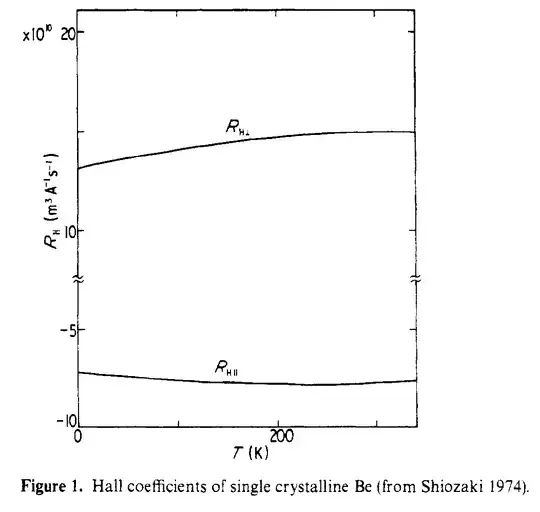

This connection of that structure to the Hall effect is covered in Shiozaki, J. Phys. F. The in-plane and out-of-plane Hall coefficients are of different sign since they see very different transport paths. Figure on, below, shows the parallel and perpendicular Hall coefficients measured for single crystal Be.
To quote from the abstract,
It is found that the large absolute values of R$_{Hparallel}$, and R$_{Hperp}$ are due to light electrons and light holes respectively.
In particular, looking at FIg. 3 in the paper one sees that the 'coronet' has hole conduction and the 'cigar' has electron conduction. These two very different Fermi surfaces then lead to two very different Hall behaviors.

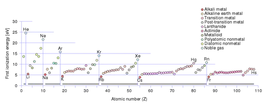

As positive charge carriers can be holes and ions. If you take a look at first ionization energies of metals : enter image description here
You will see that smallest first ionization energy $\leq 5 \,\text{eV}$ has Alkali metal group:
lithium (Li), sodium (Na), potassium (K),rubidium (Rb), caesium (Cs), francium (Fr).
Alkaline earth metal group has first ionization energies between $(10\,\text{eV} \geq E_{\text{ionization}} \geq 5\,\text{eV}) $. To this group belongs :
beryllium (Be), magnesium (Mg), calcium (Ca), strontium (Sr), barium (Ba), radium (Ra).
Low ionization thresholds in Alkali and Alkaline metals can be seen as a good support for greater concentration of free electrons in such metals and this implies of greater concentration of positive charges - holes & ions in them too, because when atom is ionized - loosely coupled electron is removed from it and becomes a free electron, thus atom becomes positively charged ion, or in other terms - in a place where electron was before, now is a hole, $^+_Ø$ charge.
