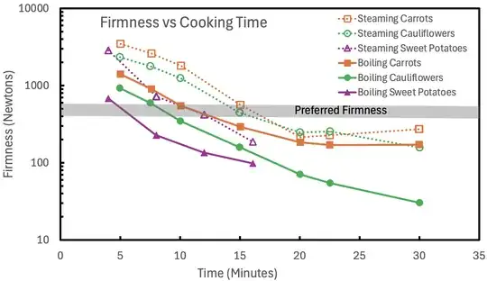

Another way to compare steaming and boiling is to measure how fast a vegetable softens. As shown in the plot below, Buratti et al. (2020) found that the desired firmness was reached faster by boiling than steaming for cauliflowers, carrots, and sweet potatoes.
firmness vs cooking time for boiling and steaming of cauliflowers, carrots, and sweet potatoes
In addition to the data showing that steaming is usually slower than boiling, the often small differences between steaming and boiling times indicate that the limiting factor on cooking times is not the heat transfer from the water/steam through the surface of the food item, but the effective thermal conductivity within the food.
