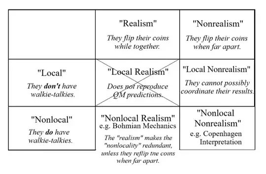

Author's Clarifications, 9/16/2024
The answers so far (especially from @flippiefanus) have helped clarify what I mean by "realism". Ironically, by "realism" I mean theories which do not treat the “wave collapse” as something real, but as merely a representation of the experimenter’s changing knowledge of the situation. The experimenter discovers where the particle really was: the concealing “fog” of the superposition burns away. But those who hold that wave collapse is real are, in regards to the particle, “nonrealist”: before measurement, the particle was in a strange, superpositional, spread-out state. Here, there is a change in the state of the particle, not merely in the experimenter. The particle has no trajectory; it sprung out of the wave function at measurement.
To put my cards on the table, I strongly favor the “realist” view: I prefer for superposition to represent the state of our knowledge, not of the system itself. I have an affinity for Bohmian Mechanics, and I’m excited that people say it still has a chance. But I struggle to believe them, due to my (mis?)understanding of the Bell test.
I hope this may be more clearly illustrated with the following, which was inspired by @KDP 's answer:
Local Realism Alice and Bob each flip a coin. They see the other's result. They then go into separate rooms and write what they each got. They give their answers to Sarah, who checks if their answers match. Obviously, they'll match 100% of the time. But Bell's Theorem disqualifies this approach.
Local Nonrealism Alice and Bob go into separate rooms, and each flips a coin. They still have to guess what the other got, without communicating to each other. Thus, only having knowledge of what they themselves got, they have only a 50% chance of guessing the full result correctly. My (mis?)understanding of EPR was that it disqualified this possibility.
Nonlocal Nonrealism Alice and Bob go to separate rooms, flip their coins, but then communicate their results to each other via walkie-talkie before writing them down. (I take this to be the Copenhagen Interpretation post-Bell.)
Nonlocal Realism E.g., Bohmian Mechanics. Alice and Bob flip their coins in the same room, and move to separate rooms afterwards. They also have walkie-talkies with which to communicate with each other. But this seems redundant; they don't need a walkie-talkie, they already know what the other's answer is. The walkie-talkies (nonlocality) are unnecessary to explain their 100% success rate; that is taken care of by the "realism" part (the fact they flipped their coins before separating).
However, the walkie-talkies would not be redundant if Alice and Bob reflipped their coins once they were separated. In other words, the particles change mid-flight between the source and the detector, while nonlocal influences ensure they nevertheless remain continually anticorrelated.
So I think my question has effectively morphed into: Is this effectively what Bohmian Mechanics requires? Or, alternatively: How is Nonlocal Realism a viable stance?
Four possible games
