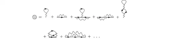

Below are the equation for the action (1) and for the self-energy (2) and the diagrammatic expression for each term; the first(second) term of the LHS of (2) for the first(second) diagram in the figure. $\phi = \{\phi^a\}$ is an N-component vector field with $a=1,...,N$. $G_{0,\textbf{p}}$ is the Fourier component of the free Green's function, $G^{ab}_0(x-y)\equiv\langle\phi^a(x)\phi^b(y)\rangle_0$.
$(1) \quad S[\phi] \equiv \int d^dx \,(\frac{1}{2}\partial\phi\cdot\partial\phi +\frac{r}{2}\phi\cdot\phi+\frac{g}{4N}(\phi\cdot\phi)^2)$
$(2) \quad\Sigma_{\textbf{p}}^{(1)}=-\delta^{ab}\frac{g}{L^d}(\frac{1}{N}\sum\limits_{\textbf{p}'}G_{0,\textbf{p}'}+\sum\limits_{\textbf{p}'}G_{0,\textbf{p-p}'})$

The wavy line is a notational device that splits the four-point vertex into two sides. Given the interaction $$ \frac{g}{4N}\sum_{a,b}(\phi_a \phi_a) (\phi_b \phi_b), $$ it is obvious that the $O(N)$ index is separately conserved within each pair. It is diagrammatically useful to indicate the pairing; thus the wavy line that makes a distinction of two sides. If you think this resembles a propagating photon too much, feel free to change the notation to anything else that pleases you. The corresponding Feynman rule for the vertex
4-pt vertex
is $ \frac{g}{N} \delta_{ab}\delta_{cd} $ (up to sign and prefactor). There is obviously no momentum dependence, but momentum can "flow" across the wavy line: it is, after all, a glorified 4-point vertex that facilitates momentum exchange. But the wavy line does not "carry the O(N) charge", so to speak.
Now let's look at the one-loop self energy diagrams:
self energy
The first diagram is rearranged to make it resemble the second. Those $G_{0,p}$ appearing in $\Sigma_{p}^{(1)}$ in OP's question refer to the looping boson lines, not the wavy lines.
It should now be obvious that only the second diagram, that has a complete boson loop in this notation, contains a trace over O(N) flavors resulting in a factor of N. (I have no idea which term is which in OP's expression (2).)
