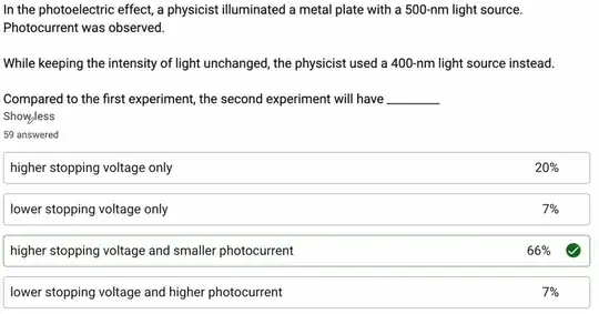

The video in the link above also showed this question where the physicist used a smaller wavelength (400nm instead of 500nm), which means a larger frequency. The correct answer for that question was higher stopping voltage and smaller photocurrent as you can see: enter image description here
So basically if you keep the intensity/the number of photons the same, your photocurrent should go down according to the math, right?

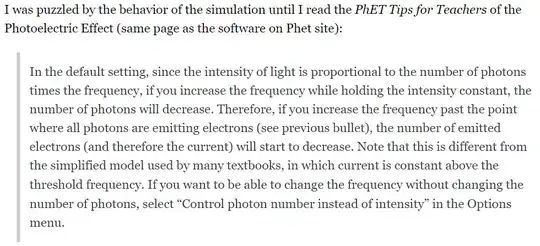

I played with this PheT https://phet.colorado.edu/sims/cheerpj/photoelectric/latest/photoelectric.html?simulation=photoelectric, and found that the current did indeed decrease after the threshold frequency. (NOTE: this is due to the settings of the simulation, which is explained in the answer of the following post)
This post explains why the simulation acts the way it does: What is the relationship between photocurrent vs frequency?. enter image description here

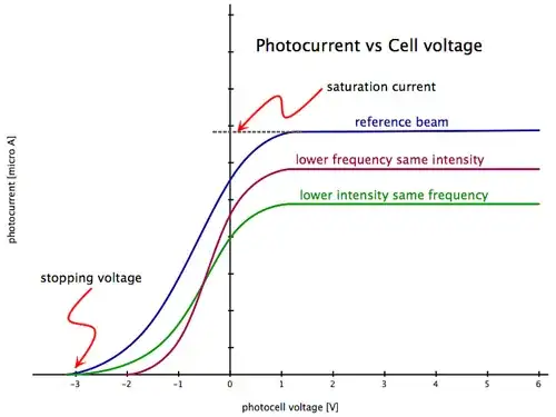

Theres also these two graphs which contradict eachother. I found this one online, which shows that the photocurrent decreased with a lower intensity but same frequency: enter image description here

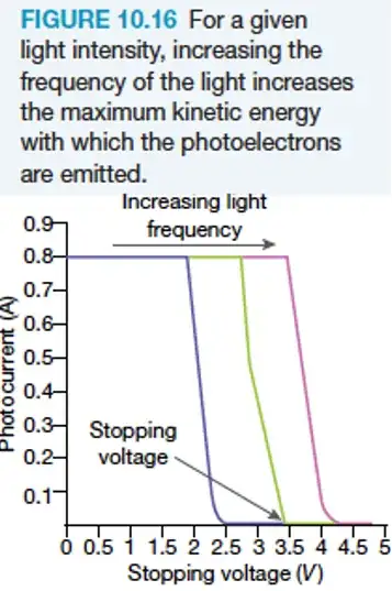

and then theres this graph from my textbook which shows the same photocurrent despite increasing frequency: enter image description here
So what exactly is going on, do textbooks use a simplified model? Does that mean frequency does not change photocurrent, or is that just what the textbook says? Can someone please definitevly explain the relationship between photocurrent and frequency as simply as possible. I'm in highschool btw.
