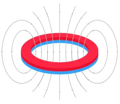

I always thought that the field of a short length axially magnetized ring magnet resembles this illustration here of Fig. 1 similar to the magnetic field of a single current loop:
Ring Magnet correct field
Fig.1 Axial Ring Magnet Field (macroscopic far-field)
Red is the North pole face of the magnet and blue the South pole.

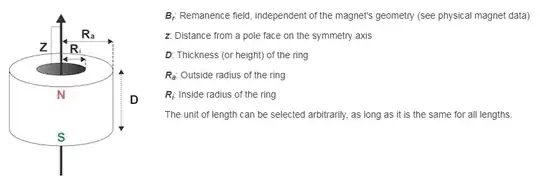

This last second image above of Fig. 2 referring to the field of a short length axial ring magnet is IMHO a misinterpretation and wrong application of a technical formula for the flux density calculation of the field wrongly applied for the inner air gap of a ring magnet:
$$ B=\frac{B_r}{2}\left[\frac{D+z}{\sqrt{R_a^2+(D+z)^2}}-\frac{z}{\sqrt{R_a^2+z^2}}-\left(\frac{D+z}{\sqrt{R_i^2+(D+z)^2}}-\frac{z}{\sqrt{R_i^2+z^2}}\right)\right] $$
Formula notes
This formula is indented to calculate only the field of an axial ring magnet for a distance $z$ from the pole face of the magnet and NOT its inner air gap center origin. Somebody, took literally this equation and simulated this graph that is IMO utterly nonsense with magnetic polarity flip inside the air gap! Source link.

Figure 2 is the correct depiction of the magnetic field, Figure 1 is incorrect. If you look at the field lines of a regular bar magnet, and compare them to one side of the cross-section in Figure 2, they have the same basic field line behavior. One especially clear behavior is that in the horizontal plane cutting through the bar magnet, all the field lines point in the same direction. Unlike in Figure 1, where the field lines are completely different, with some field lines pointing up, and others pointing down.

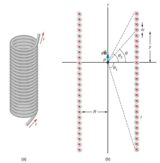

But that's just not true. A derivation of that formula includes this nice illustration of the geometry:
solenoid geometry
with angles $\theta_{1,2}$ the "viewing angles" between the point of interest and the corners of the cylinder of current. The relationship is then $$ B_\text{finite}(z) = \frac{B_\text{limiting}}{2} \left( \sin\theta_2 + \sin\theta_1 \right) $$ where $B_\text{limiting}$ is the infinite-solenoid limiting field. Of course we can use the solenoid equation to find the field on the axis of a permanently-magnetized cylinder, remembering that the cylindrical surface carries a "bound surface current," so long as we're prepared to hide from the grizzled experimentalist who wants to remind us of the differences between $\vec B$ and $\vec H$.
It's straightforward to recast the equation in your question into $$ \begin{align} B_\text{hollow}(z) &=\frac{B_r}{2}\left[\left( \frac{D+z}{\sqrt{R_a^2+(D+z)^2}}-\frac{z}{\sqrt{R_a^2+z^2}} \right)-\left( \frac{D+z}{\sqrt{R_i^2+(D+z)^2}}-\frac{z}{\sqrt{R_i^2+z^2}} \right)\right] \\&= \frac{B_r}{2} \big( \left(\sin\theta_1 + \sin\theta_2\right)- \left(\sin\phi_1 + \sin\phi_2\right) \big) \end{align} $$
with the two $\theta$ the viewing angles to the outer corners, with $R_a$ in the denominators, and the two $\phi$ the viewing angles to the inner corners, with $R_i$ in the denominators.

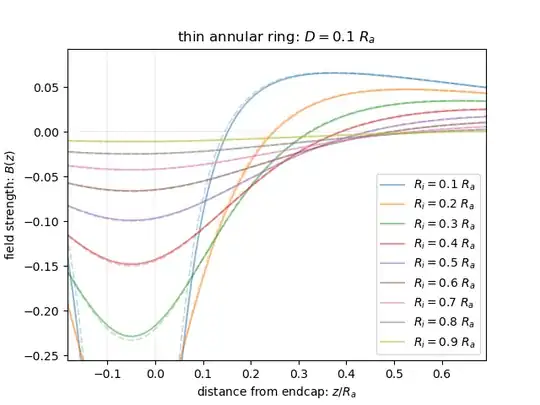

  • If the magnet is a thin disc with $D \ll R_i < R_a$, as in your two figures, we can ask what the field looks like in the vicinity of $z\approx R_i$. After an annoying amount of effort, I managed to find an expression which drops terms of order $\mathcal O(D/R)^2$: $$\begin{align} \frac{D+z}{\sqrt{R^2+(D+z)^2}} %&= \frac{ \frac zR\cdot(1+\frac Dz) }{ \sqrt{ 1 + \left(\frac zR\right)^2\left(1 +2 \frac Dz \color{lightgray}{{}+ \mathcal O\left(\frac Dz\right)^2}\right)}} \\ %&=\frac{\frac zR}{\sqrt{1 + \left(\frac zR\right)^2}}\cdot \frac{1 + \frac Dz}{\sqrt{1 + 2\frac Dz\left(1 + \left(\frac zR\right)^2\right)^{-1}}} \\ %&=\frac{z}{\sqrt{R^2+z^2}}\cdot\frac{1 + \frac Dz}{\sqrt{1 + 2\frac Dz\frac{z^2}{R^2+z^2}}} \\ %&\approx \frac{z}{\sqrt{R^2+z^2}}\cdot\left( 1 + \frac Dz\right)\cdot\left( 1 - \frac 22\frac Dz \frac{z^2}{R^2+z^2} \color{lightgray}{{}+ \mathcal O\left(\frac Dz\right)^2} \right) \\ %&= \frac{z}{\sqrt{R^2+z^2}}\cdot\left( 1 + \frac Dz \frac{R^2}{R^2+z^2} \color{lightgray}{{}+ \mathcal O\left(\frac Dz\right)^2} \right) \\ &\approx \frac{z}{\sqrt{R^2+z^2}} + \frac DR \left(\frac{R}{\sqrt{R^2+z^2}}\right)^3 \end{align} $$ This approximation gives a field $$ \begin{align} B &\approx \frac{B_r}{2} \cdot\left( \frac D{R_a}\left(\frac{R_a}{\sqrt{R_a^2+z^2}}\right)^3 - \frac D{R_i}\left(\frac{R_i}{\sqrt{R_i^2+z^2}}\right)^3 \right) \end{align} $$ I had hoped this would give an expression for the location of the field zero for a thin-disc ring magnet in terms of $R_i/R_a$, but setting $B=0$ gives a cubic polynomial in $z^2$ whose roots I'm not able to interpret in a sensible way. Some numerical analysis suggests that, in the limit of a very thin annulus $R_i\to R_a$, the zero in the field approaches $z=\frac 23 R_a$.
    data plot
    Here's a plot of the field where this thin-disc limit starts to be useful, with the thickness of the ring at 10% of its outer radius. The different curves are for different inner radii. The reversed field (on axis) gets stronger as the hole gets smaller. The solid curves are the exact expression from your question. The dashed curves are the cubic approximation that didn't turn out to be helpful, but they are good approximations, so at least that slog wasn't fruitless and wrong.
These two limits actually show us the behavior of the field over the entire parameter space. The field in the hollow core of the ring magnet is always opposite the magnetic moment of the ring magnet. As the ring magnet gets shorter, from a cylinder to a disc, the reverse-direction field leaks out of the end somewhat, but never further than about two-thirds of the radius of the ring.

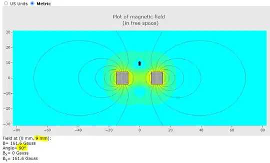

$(1)$ The field illustration of Fig. 1 of the question, represents the macroscopic far-field of the ring magnet on air, for point measurement distances from the inner center of the ring magnet larger than approximately the inner radius of the magnet thus in the case of this experiment for measurement points at distances $R_{m}>7.5mm$ from the inner center of the magnet.
This can be also confirmed as LPZ mentioned using the K&J simulator for the above specified magnet, see below for distance $R_{m}=9mm$,
test 1
Black arrow shows point measurement position and also North magnetic polarity (i.e. arrow points up).

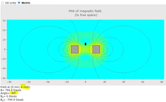

$(2)$ The field of Fig. 2 represents the microscopic near-field of the ring magnet on air, for point measurement distances from the inner center of the ring magnet smaller than approximately the inner radius of the magnet thus in the case of this experiment for measurement points at distances $R_{m}<7.5mm$ from the inner center of the magnet. In this case, yes indeed I have observed a polarity flip by using a second 3mm and 1mm thick square plate neodymium magnet N42 grade in the center hole area of the ring magnet as correctly shown in Fig. 2 of the question.
test 2
Black arrow shows point measurement position and also South magnetic polarity (i.e. arrow points down). Measurement point taken at $R_{m}=6mm$ distance from inner center of ring magnet.

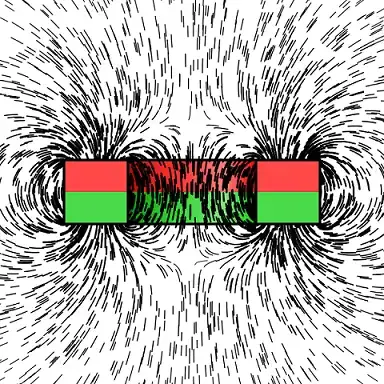

Simulated iron filings field depiction of the total cross-section field on air of a ring magnet:
Credits: https://commons.wikimedia.org/wiki/File:Ironfilings_ringmagnet.svg
Note: The strongest dominant part of the field shown in above image is the one closer to the bulk material (i.e. body) of the ring magnet.
