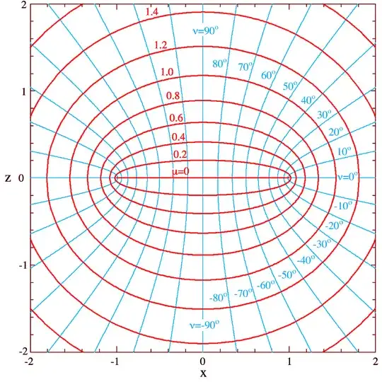

Now for the central disk of Kerr. In Schwarzschild we say that $r\in (0,\infty)$ necessarily because there is a full-blown curvature singularity at $r=0$, no matter from which direction you approach. In Kerr this is not the case. In particular, by transforming to Kerr-Schild coordinates, one sees that Boyer-Lindquist $r=const.$ surfaces are oblate ellipsoids, and the $r=0$ surface corresponds to the disk at the origin in oblate spheroidal coordinates: enter image description here Another way to show that $r=0$ is not a point is to observe the fact that physical scalars such as the Kretschmann scalar are dependent on $\theta$ at $r=0$.
