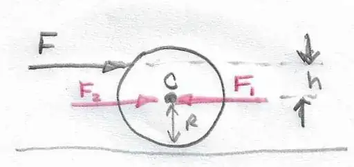

A solid sphere of radius R is placed on smooth horizontal surface. A horizontal force F is applied at height h from the lowest point. For the maximum acceleration of centre of mass, which is correct?

There is one horizontal force, $F$, acting on the sphere.
Applying two equal magnitude, $F$, and opposite direction to each other forces, $F_1$ and $F_2$, at the centre of mass $C$ results in a force $F_2$ acting at the centre of mass of the sphere which produces a translational acceleration, $a$ of the centre of mass $(F=m\,a)$, and a couple $F\,h$ which produces an angular acceleration, $\alpha$, about the centre of mass $F\,h= I_{\rm com}\alpha$.
So the linear acceleration is independent of the position the force $F$ is applied, Option $D$, and there will be an angular acceleration of the sphere unless $h=0$.
