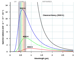

All matter in bulk radiates (approximately) as a black body radiator, approximately because there are coefficients of emissivity depending on the constituents. For gases the functional form is different.
The radiation has a specific spectrum and intensity that depends only on the temperature of the body
As the temperature decreases, the peak of the black-body radiation curve moves to lower intensities and longer wavelengths. The black-body radiation graph is also compared with the classical model of Rayleigh and Jeans.
Note that most of the radiation is in the infrared.
