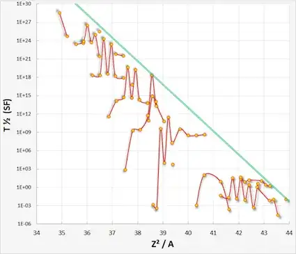

"Stable" nuclei above iron don't immediately decay because there is a potential barrier between the initial and final states. For example, for a nucleus to undergo spontaneous fission, it must first start to elongate before splitting, but this elongated state has higher energy than the initial state. This makes the decay impossible classically, but quantum tunnelling makes it possible with a rate that is exponentially sensitive to the height of the barrier which depends on the ratio of Coulomb repulsion to nuclear attraction, i.e. $Z^2/A$.
From Wikipedia we can see how the spontaneous fission lifetime depends on $Z^2/A$ for heavy radioactive elements such as uranium.
If we very, very naively extrapolate the green line down to elements close to iron, we find lifetimes $\sim 10^{125}$ seconds, more than a hundred orders of magnitude longer than the current age of the universe. This extrapolation is, of course, at best an order-of-magnitude estimate of the order-of-magnitude and might better be written as $\sim 10^{10^{\sim2}}$ seconds.
