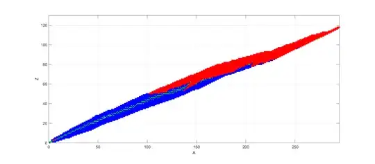

However, just like the stellar formation processes favour $^{56}$Fe over $^{62}$Ni despite the energy difference because of the relative scarcity of neutrons to bridge the gap between them, the actual decay processes in the far future also seem to lead to trapping in other isotopes. $\alpha$-decays require a positive Q-value for $^{A}_{Z}X\rightarrow ^{A-4}_{Z-2}Y+\alpha+Q$: this becomes common above $A>102$, but below the energy difference is too small to allow $\alpha$-decay. $\beta$-decay to the rescue! They (and electron capture) happen across the entire $A$ range, but only change $Z$ by $\pm1$. So this appears to lead to a lock-in where heavy element decay get stuck in the region $62>A>102$. In this argument I have assumed that any energetically allowed transition will eventually happen; at least some $\beta$-decays are presumably blocked by spin considerations.
Plot of potential decays in (A,Z) plane: blue beta decay/electron capture, red alpha decays. Green isotopes do not have any energetically allowed decays. White circles mark iron-56 and nickel-62.
Plot of hypothetical decays in (A,Z) plane: blue beta decay/electron capture, red alpha decays. Green isotopes do not have any energetically allowed decays. White circles mark iron-56 and nickel-62.
I seriously doubt Dyson would have made a mistake (even though this is an extremely minor part of the paper), so what is going on? Spontaneous fission reducing everything to the iron peak? Or is the long-term chemical composition of the universe a mixture of stable heavyish elements?

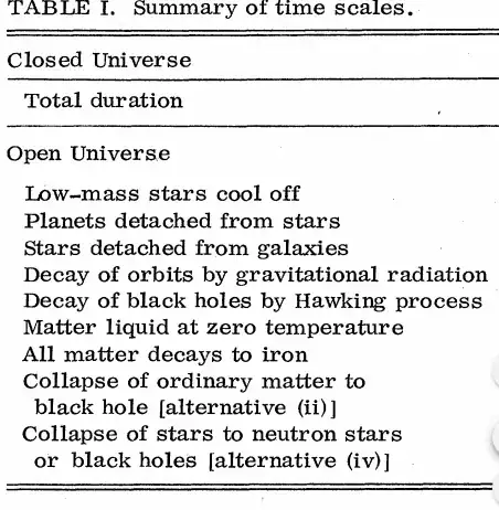

I went through your link, and this is an answer to your title,
What is the extreme long-term elemental composition of the universe?
The summary answer is the the table given in the link:
dyson universe
To clarify, all matter turns to iron is talking about matter in stars,
After the time ($=10^{1500}$ yrs) elapsed, most of the matter in the universe is in the form of ordinary low-mass stars that have settled down into white dwarf configurations and become cold spheres of pure iron.
not all matter in the universe, which still will have in the huge empty spaces hydrogen mainly but also a lot of atomic matter debris which at the temperature of zero will not meet another debris to fuse into anything. (Of course radiation will be there also). He proposes iron t so he can do some calculations.
Whether stars become iron or another element , or many elements is immaterial to his discussion which leads to the alternatives of neutron stars and black holes, which is the point of his perambulation. All this assuming that the protons do not decay, and he gives references to later theoretical papers, where proton decay is calculated.
