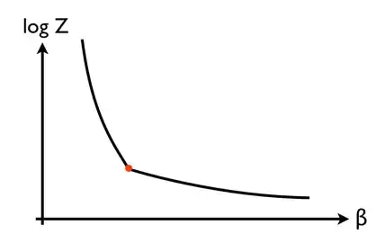

A first-order phase transition has a discontinuity in the first derivative of $\log Z$ with respect to $\beta$:

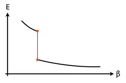

Since the energy is related to the slope of this curve ($E = -d \log Z / d\beta$), this leads directly to the classic plot of energy against (inverse) temperature, showing a discontinuity where the vertical line segment is the latent heat:
If we tried to plot the second derivative $\frac{d^2 \log Z}{d\beta^2}$, we would find that it's infinite at the transition temperature but finite everywhere else. With the interpretation of the second derivative in terms of heat capacity, this is again familiar from classical thermodynamics.

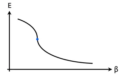

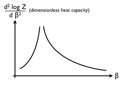

So far so uncontroversial. The part I'm less sure about is how these plots change in a second-order transition. My guess is that the energy versus $\beta$ plot now looks like this, where the blue dot represents a single point at which the slope of the curve is infinite:
The negative slope of this curve must then look like this, which makes sense of the comment on Wikipedia about a [higher] derivative of the free energy "diverging".
If this is what second order transitions are like then it would make quite a bit of sense out of the things I've read. In particular it makes it intuitively clear why there would be critical opalescence (apparently a second-order phenomenon) around the critical point of a liquid-gas transition, but not at other points along the phase boundary. This is because second-order transitions seem to be "doubly critical", in that they seem to be in some sense the limit of a first-order transition as the latent heat goes to zero.
However, I've never seen it explained that way, and I have also never seen the third of the above plots presented anywhere, so I would like to know if this is correct.

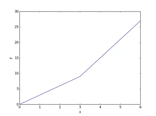

I'll give an alternate view of how second order phase transitions may look like. Let us study a parameter $F$. If there is a second order phase transition in $F$, then the second derivative would be discontinuous but won't diverge, as for the heat capacity below: enter image description here and first derivative should look like:
First Derivative

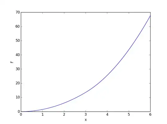

Interestingly, the plot of $F$ itself may be continuous and differentiable everywhere. The first derivative is non-differentiable at a point because the functional form of $F$ is changing, although we can't see it in the plot. enter image description here It is non differentiable at the special point because the function $F$ is actually a piecewise function as below: $$F= \begin{cases} \frac{3x^2}{2} & 0\leq x\leq 3 \\ 13.5+2(x-3)^2 & 3\leq x \end{cases} $$

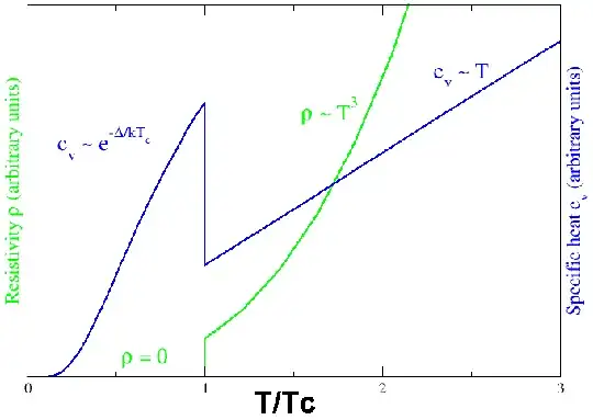

I believe there are "second-order transitions of the type that Ehrenfest conceived" in superconductors (http://en.wikipedia.org/wiki/Superconductivity#Superconducting_phase_transition ).
One of the modern classifications of phase transitions: "first-order" and "continuous" (http://en.wikipedia.org/wiki/Phase_transition#Modern_classifications )
