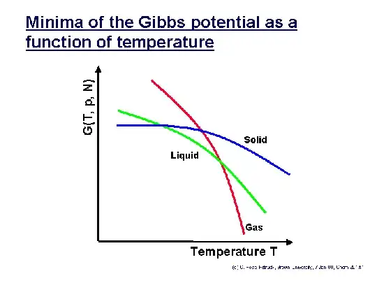

Another way to look it is that reducing the solvent concentration of the liquid from 100% to <100% lowers its Gibbs free energy curve:
The Gibbs free energy (which considers Nature’s favoring of both strong bonding in condensed matter and the many arrangements in a gas, as mediated by the temperature) is minimized for spontaneous processes and stable matter. The chemical potential is itself simply the Gibbs free energy per mole of substance.
Note how pushing the liquid curve down would push the intersections farther out. This provides a graphical explanation for why and how impurities depress the freezing while elevating the boiling point.
