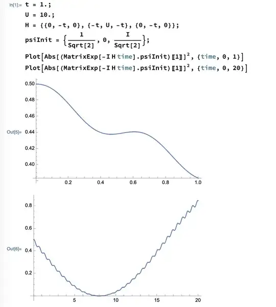

You can think of similar dynamics in a simpler case. Consider the Hamiltonian of a single particle in three orbitals $H = -t(c^\dagger_1 c_2 + c^\dagger_2 c_3 + H.c.) + U c^\dagger_2 c_2$ (with $U\gg t$), and start with the electron in the wavefunction $(1/\sqrt{2},0,i/\sqrt{2})$ and looking at the current from $1\to3$. I recommend plotting the three probability amplitudes on Mathematica to get a feel for it! At short times $T \sim 1/t \equiv T_1$, you will see that your result is correct; the initial $\langle\dot{N}_3 - \dot{N}_1\rangle$ is indeed zero. But if you plot it for very long times $\sim U/t^2 \equiv T_2$ (that is, you coarse grain and study dynamics over timescales $\gg T_1$), you see that there is a non-zero current from site 1 to 3 at $T=0$. Try to guess an effective Hamiltonian with only sites 1 and 3 that describes this dynamics!
Edit: I am adding the plots for this simple model from Mathematica for clarity. I am plotting the probability for the particle to be at site 1 as a function of time for $t = 1, U = 10$.
Plots from Mathematica for toy model
Now, imagine the experimentalist does not have the ability to resolve timescales at the order of $1/t$ but only sees the coarse-grained charge (as a function of time) in their measurements. What would they conclude is the current at time $=0$? The point is that this is non-zero even though the true current in the model is zero, and this non-zero value is estimated correctly by using the two-site effective model you get from second order perturbation theory $$ H = -\frac{t^2}{U}(c^\dagger_1 c_3 + \textrm{h.c.}) $$
