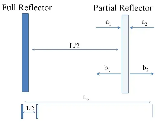

Laser Cavity
My drawing shows a cavity comprising a full reflector at one end, and a partial reflector (to get our laser light out of the cavity) at the other. We assume there is one resonant spatial mode in the cavity (e.g. the fundamental Hermite-Gauss or Laguerre-Gauss mode). The mirror's action is characterized by its scattering matrix relating the reflected wave amplitudes $b_1,\,b_2$ linearly to the incident wave amplitudes $a_1,\,a_2$. For a lossless mirror, the scattering matrix is unitary, and, given the symmetry of the mirror's action (if it works the same whether flipped over or not) the most general $2\times2$ unitary relationship is:
$$\left(\begin{array}{c}b_1\\b_2\end{array}\right) = e^{i\,\alpha}\left(\begin{array}{cc}\cos\phi&i\,\sin\phi\\i\,\sin\phi&\cos\phi\end{array}\right)\left(\begin{array}{c}a_1\\a_2\end{array}\right)\quad\quad\quad(5)$$
Now if we were to second quantize the one-dimensional EM field in this problem, we might use a long, length $L_Q$ quantisation volume as sketched at the bottom of my drawing and we write down the eigenmodes of this system. If the cavity's there and back length is $L$, so that the "output" $b_1$ is fed back into the input $a_1$ through the optical the loop phase delay $\exp(i\,2\,\pi\,n\,L/\lambda)$ where $n$ is the cavity's effective refractive index and $\lambda$ the freespace light wavelength, then Eq. (5) together with the equation $a_1 = \exp(i\,2\,\pi\,n\,L/\lambda)\, b_1$ (assuming that $\lambda$ is one of the system modes allowed by the quantisation length $L_Q$ - we assume $L_Q\to\infty$ so that the allowed values of $\lambda$ become more and more densely packed) we can show that the monochromatic system modes are defined by the following relationships between the amplitudes of the wave $a_1$ in the cavity the wave $b_2$ scattered by the cavity and the wave $a_2$ incident on the cavity:
$$b_2 = a_2 \frac{e^{i \alpha } \left(-\cos\phi+\exp\left(i \left(\alpha +\frac{2 \pi L n}{\lambda }\right)\right)\right)}{-1+\cos\phi \exp\left(i \left(\alpha +\frac{2 \pi L n}{\lambda }\right)\right)}\quad\quad\quad(6)$$ $$a_1 = a_2\frac{i \sin\phi \exp\left(i \left(\alpha +\frac{2 \pi L n}{\lambda }\right)\right)}{1-\cos\phi \exp\left(i \left(\alpha +\frac{2 \pi L n}{\lambda }\right)\right)}\quad\quad\quad(7)$$
The ratio $b_2 / a_2$ has unit magnitude (to see this, take heed that the numerator is a unit magnitude phase factor time the conjugate of the denominator), so nothing unforeseen here - this has to be so by energy conservation (there is no loss in the cavity and energy cannot get out though the full mirror at the left hand side of my drawing). But now let's look at the and the ratio $a_1 / a_2$ of the cavity field amplitude to that of the field outside, supposing that the mirror is designed so that $\phi$ is small, i.e. it is almost fully "silvered". A given photon's number of recirculations is then exponentially distributed with the recirculation number $N$:
$$p(N) = \sin^2 \phi \, \cos^{2 (N-1)} \phi\quad\quad\quad(8)$$

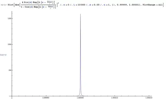

and the mean number of recirculations is $\sum\, N\, p(n) = (\sin\phi)^{-2}$, so each photon travels a mean length of $L / \sin^2\phi)$ through the gain medium before escaping to the output. This factor $(\sin\phi)^{-2}$ which defines how much the cavity's length is magnified by the multiple bounces is called the cavity's Finesse. I plot below the ratio $|a_1 / a_2|^2$ when $\phi = 0.05$ as a function of wavelength $\lambda$ around $\lambda = 1$ unit, so that we have a finesse of roughly 400 (a pretty high quality cavity) and a cavity length of nominally $10000\lambda$; here I assume that the common mode phase delay $\alpha$ is nought and with vacuum in the cavity. I have included a plot of a the central peak at $\lambda = 1$ and also a log-log plot over a much wider (but still narrow) wavelength range to show the wavelength-periodic behavior - the cavity is said to have a free spectral range of $\Delta \lambda = 10^{-4}$ units (i.e. this is the periodicity in wavelength).
Fabry-Pérot Response Log-Log Fébry-Perot Response
What is the point of all this? In this second quantized picture, the modes pass through the cavity almost as though it weren't there aside from when resonance traps them in the cavity. Therefore, these resonant modes are the special ones whose photons linger in the cavity much longer than those in other system modes. So if a spontaneous emission from an atom in the cavity adds one photon to any mode, this photon's field of influence is spread thinly over the whole, length $L_Q$ system if the mode is not a resonant one. Such photons therefore will not be amplified, or only so at tiny probability. It is only photons emitted into the resonant modes that stand a chance of stimulating an emission, thus adding another photon to the same mode and so on, because these are the ones whose field of influence is much more tightly confined to the cavity. This is the intuitive reason for how the cavity shapes the spectrum of the spontaneously emitted photons.
