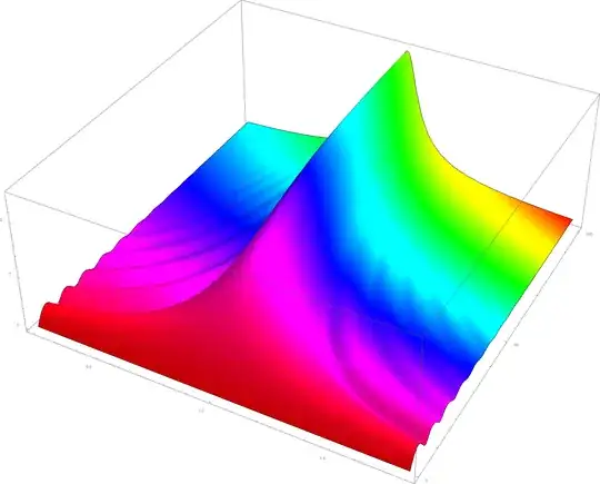

A plot of this process is shown below:
This plot shows the probability amplitude:
$$\psi_+(\omega,\,t)\approx i \sqrt{\frac{2\,\tau}{\pi}} \,e^{-i\, t\, \omega }\, \frac{1-\exp\left(-t\,\left(\frac{1}{2\, \tau }+i\,\omega_0\right)\right)}{2 \,\tau \, (\omega -\omega_0)+i}\tag{2}$$
for the photon to be found in an EM field mode with frequency $\omega$ (nearly transverse axis) against time $t$ (axis moving away from viewer). The atom transition energy is such that $\omega_0 = 1$ on this plot, and the transverse axis stretches from $\omega=0$ (left) to $\omega=2$ (right). The relaxation time $\tau=10$ and the time axis stretches from $t=0$ to $t=100$. The magnitude is encoded as the vertical axis, the phase as hue. It can be seen that at small times, the probability amplitude is spread over a very wide frequency band, but, owing to the destructive interference mentioned, concentrates itself around the center frequency as $t\to\infty$, such that the probability density becomes a Lorentzian function of frequency.
