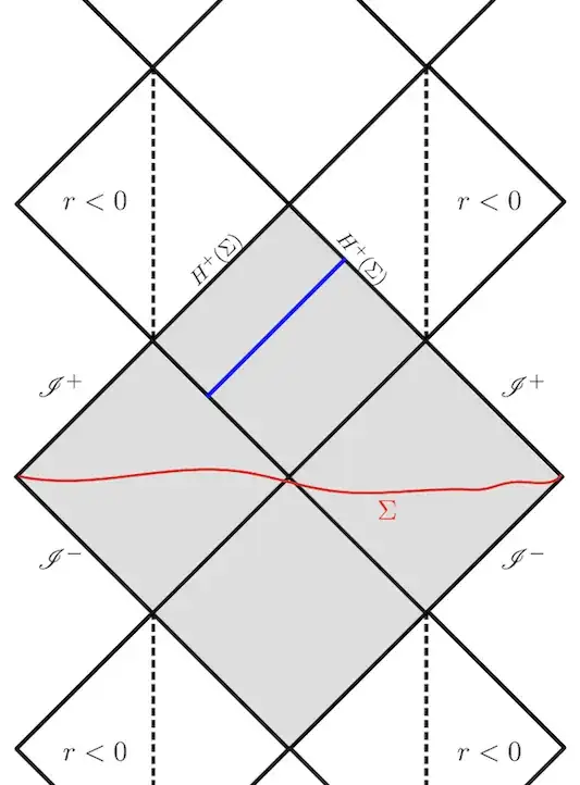

To illustrate, consider the following portion of the Penrose diagram of the $\theta = 0$ cross-section of the maximally extended Kerr spacetime.
$\hspace{3cm}$enter image description here
The red hypersurface $\Sigma$ cuts across the exterior asymptotically flat region, and its Cauchy development (the portion of the spacetime determined by $\Sigma$ from the vacuum Einstein equation) is shaded in gray. The inner horizon is the future Cauchy horizon $H^+(\Sigma)$ of $\Sigma$. One of the example curves that Kerr has identified is shown in blue.
The significance of this curve is that, since the full maximal extension is not globally hyperbolic, curves like this are all one can get from Penrose's theorem. Indeed, if one restricts their attention to the gray region, this subset is globally hyperbolic, and the theorem does apply here: it tells us the gray region is null geodesically incomplete as a spacetime in its own right. Of course, that this region is incomplete is nothing new since we already know we can extend the metric beyond it, and the incompleteness of the gray region has nothing to do with any singular behavior that may or may not arise beyond the Cauchy horizon under such an extension. Since they are incomplete in the gray region, Kerr's curves provide explicit examples of the null geodesics guaranteed by the theorem. These curves, however, do not demonstrate any kind of singular behavior-- that we know they can be extended in a larger spacetime means there's nothing singular about them. All curvature scalars are finite, etc. All Penrose's theorem tells us, then, is that null curves like Kerr's (which are decidedly nonsingular) exist in the gray region, and they are incomplete as geodesics within this globally hyperbolic set. As soon as you extend the spacetime beyond this subset by any amount whatsoever (perhaps to try to include the ring singularity), then Penrose's theorem is simply inapplicable, telling us nothing about the extension.
The upshot, then, is that Penrose's theorem does not offer any definitive proof that the interior of a stationary, axially symmetric black hole must be singular-- the incomplete null geodesics it can give us are only incomplete as geodesics restricted to the globally hyperbolic region, and this incompleteness has nothing to do with the ring singularity that may exist beyond the Cauchy horizon. While Kerr has not explicitly provided an alternative extension beyond the Cauchy horizon that is nonsingular, there is no solid reason to believe one doesn't exist. Note that the possibility of replacing the singularity here does not at all necessitate one's going so far as to model the dynamical collapse of a rotating star; it may well be the case that the ring singularity can be replaced by a stationary matter distribution beyond the Cauchy horizon while leaving the gray region entirely unchanged.

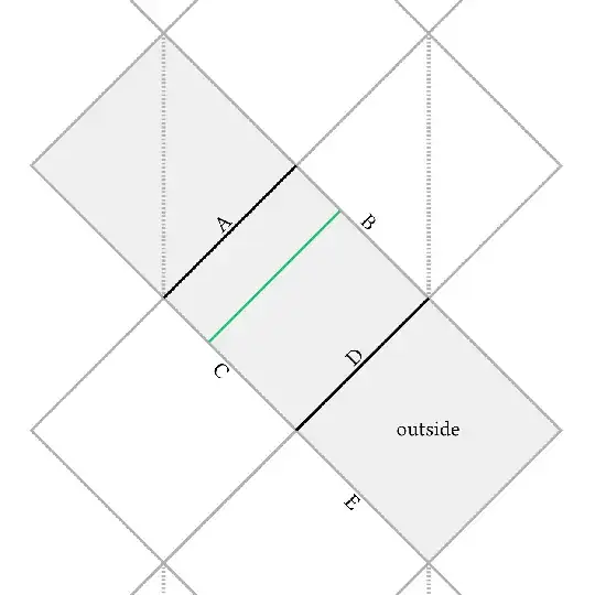

Kerr writes:
The original Kerr-Schild coordinates were deliberately chosen to be a generalisation of Eddington’s, avoiding any coordinate singularities on either horizon. It will be shown in Section 5 that through every point of these spaces there are light rays that are asymptotically tangential to one or other horizon, do not have endpoints and yet their affine lengths are finite.
The simplest example of a FALL [finite-affine-length null geodesic] [...] lies on the rotation axis between the two event horizons and is asymptotic to each of these. It is what one gets when a torch is shone ”backwards” while falling into a black hole down the axis. It does not cross either horizon.
He's evidently talking about geodesics like the one shown in green on this diagram:
This is a Penrose diagram of the maximally extended Kerr spacetime with the portion covered by Kerr-Schild coordinates highlighted. The green geodesic "ends" at the boundary of the coordinate patch only in the sense that the rest of it can't be described using those coordinates. This isn't a counterexample to the singularity theorems unless you interpret them in such a way that they're trivially wrong. The green geodesic isn't "asymptotic to" "the two event horizons" (by which he means A and D); it just looks like it is in those particular coordinates.
He argues that the horizons other than A and D aren't real. There actually are good arguments that they aren't real, but they don't support his position.
On the past side, to describe a realistic black hole that forms from a collapsing star, you need to graft a portion of the vacuum Kerr solution to some sort of spacetime describing the star. The portion that you use doesn't include the past boundary of the Kerr-Schild patch (C and E) or anything below it in the diagram. But the geodesic doesn't end there; it continues into the rest of the spacetime, which just happens to not be Kerr-shaped.
On the future side, there's an argument that if the Kerr solution is even slightly perturbed (e.g. by the presence of any matter at all) then there is a curvature singularity at A and B due to the mass-inflation instability.
Putting these together, it's plausible that the only physically relevant part of the Kerr spacetime is (part of) the middle and lower shaded squares. But Kerr's argument is that the green geodesic ends in a finite affine distance without a singularity, and that's just not true. In the future direction, it ends at a singularity. In the past direction, it extends an infinite affine distance into the pre-black-hole universe (or at least he hasn't shown that it doesn't).

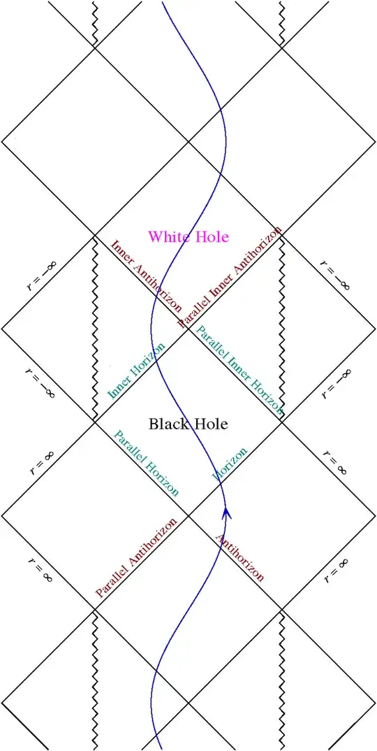

In a nutshell, the Penrose Singularity Theorem states that light inside the horizon cannot escape to infinity and therefore must end up in a singularity. This means a singularity must exist inside the horizon.
However, the Kerr spacetime allows light to escape to infinity in a different region, often referred to as "another" or "parallel" universe. Well, if light inside the horizon can escape to infinity (no matter in what region of spacetime), then it does not have to end up in a singularity. This means that in general a singularity does not have to exist inside the horizon.
This argument does not disprove the Singularity Theorem, but only indicates that the conditions required by this theorem are not satisfied by all possible types of spacetime.

Kerr is talking about realistic black holes...
Roy Kerr wrote: "...generated by real physical bodies"
so in the Penrose diagrams in the other answers where the worldlines are extended behind t=-∞ you can't do that for real.
Also there is no singularity in those diagrams since the ring is in the equatorial plane, while those diagrams are polar slices, so they do indeed show that the worldlines depicted in them do not hit the singularity, but either pass through the ring if we're talking about eternal black holes, or hit the nonsingular remains of the collapsed star if we're talking about realistic ones.
Even if there was a rotating ring singularity it would be gravitationally repulsive, so you couldn't hit it since it would deflect your trajectory away from it. Only a perfectly equatorial ray could hit the singular ring, everything else gets either deflected through it or away from it. Therefore it would be hard for the singularity to form in the first place due to the centrifugal repulsion.
In an eternal black hole you could travel into the infinite past and cross into other regions while getting fried by the infinitely blueshifted light that fell into the black hole during all that time, but in reality that t=-∞ surfaces don't exist since the black hole must be younger than the big bang, so the worldlines he is talking about are indeed of finite affine length and don't hit the singularity.
