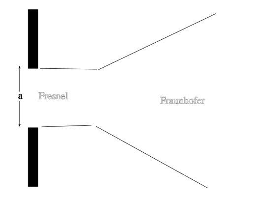

So, there is a natural trade off in our problem, between the size of our aperture and the distance we are from it. In particular, we can separate the problem into two limits, one where $ d \ll ka^2 $ where we expect large differences in phase contribution ($ \Delta \phi \gg 1 $) and $ d \gg k a^2 $ where we expect little difference in phase contribution ($ \Delta \phi \ll 1 $). These are the Fresnel and Fraunhofer regions respectively. I've included a little picture for illustration.
fresnel-fraunhofer-diffraction
As you can imagine, these two limits have very different qualitative phenomenon, and so that's why people talk about them as two different kinds of diffraction. In the Fresnel limit you have mostly geometric optics type cast shadows, with perhaps some wiggly bits near the edges of your shadow, whereas in the Fraunhofer region, our wave has spread out over a large region and starts interfering with different parts of the cast image. This leads to the observed behavior of Fraunhofer diffraction corresponding to a Fourier transform of the aperture.
