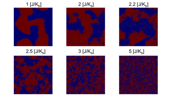

The Ising model is a nice example where you can see the effect of the size of the correlation length. You should have the following picture in mind:
The correlation length goes from finite (upper left) to infinite ($J/k_b=2.269$) to finite again. This is a typical second order phase transition. I will first discuss the precise meaning of correlation length and then I will explain how this is related to first order phase transitions.
The correlation function basically answers the following question: at which length scale do fluctuations exist? More formally, we consider a spin $\sigma_i$ at a site $i$ and we ask how much it correlates with another spin at site $j$. $$\bigg\langle(\sigma_i-\langle\sigma\rangle)(\sigma_j-\langle\sigma\rangle)\bigg\rangle$$ Note that we have to subtract the background $\langle\sigma\rangle$. Otherwise we are not measuring fluctuations. For example, at low temperatures we would always measure correlation because of the background.
For high temperature fluctuations decay exponentially fast as a function of the distance $d_{ij}$ between lattice sites. Because of the noise, the size of a fluctuation is finite. Beyond a few correlation lengths, two distinct sites have nothing to do with each other.
For low temperatures fluctuations also decay exponentially fast. The system tries to be uniform, so the fluctuations can only get so big. Note: the picture at $T=1$ is probably out of equilibrium. If given more time it would be one color.
At $T=2.269$, the correlation length diverges. No matter how much you zoom out, you will always see islands of the same color (=fluctuations). This means that a particular spin will correlate with another spin even though it is really far away.
You can now imagine red and blue representing two phases, for example ice and water. In a first order phase transition, the 'new' phase starts appearing as bubbles which grow in size, like in the $T=2$ picture. In a second order phase transition, the new phase starts appearing everywhere at once, like the pictures $T=2.2, T=2.5$. Now I will explain that is unlikely that a first order phase transition has divergent correlation length.
A first order phase transition has a discontinuity in the energy, which means there is latent heat when going through the phase transition. What would happen if a system with latent heat has divergent correlation length? The system would phase transition everywhere at once! All the latent heat would start releasing at every length-scale.
To put differently, in first order phase transitions there is some cost associated with going between different phases. This puts a limit on the size of fluctuations.
This story is not a derivation in the slightest, but hopefully this gave some physical intuition.
