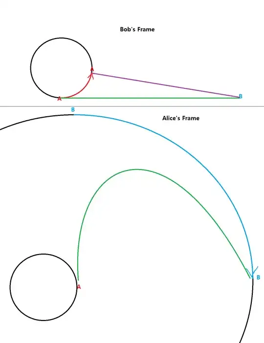

To understand what's going on, get rid of gravity and consider the problem in two dimensions. Alice is on a rotating platform. She tosses a ball to Bob, standing on the ground a few meters away, when he is tangent to the rotation of the platform. Alice watches Bob traverse a big arc like the sun going across the sky, while the ball homes in on Bob on an intercept course, propelled by a psuedoforce. Bob, of course, watches Bob stand still where he started, while the ball goes in a straight line from where Alice started to where Bob started.
(I made the below illustration in MSPaint, so don't expect the curves to be quite right.)
