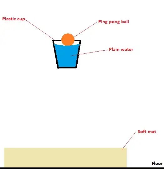

I'm trying to modelise the ping pong and water cup experiment. They were already questions on stackexchange about this:
Why does a ping pong ball bounce higher when it is dropped together with a cup of water?
but I would try an approach with Archimede Force and superficial tension.
Image of the experiment
I want to apply Newton's law on the ping pong ball, but the water and the cup are moving too and I don't know how it works in that case or how to modelise it... What do you think about it?
Since the experiment can replace the water by sand or by a poorly bouncing heavier ball I think the approach with Archimedes law does not work better than the explanations in the other link.
