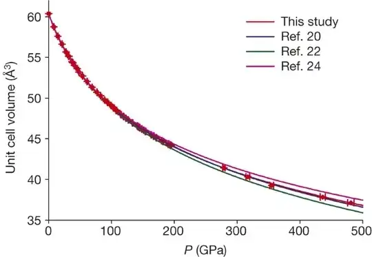

Osmium’s density at 500 Gpa is about 35~36 g/ml according to osmium unit cell volume from dividing the room temp density by the percent volume
see https://www.nature.com/articles/nature14681
