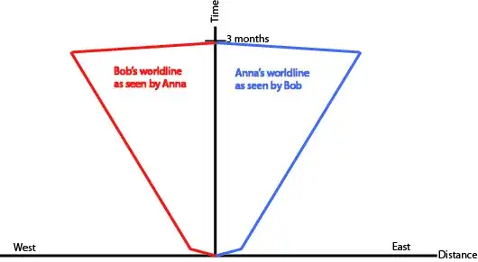

UPDATE: I have created the spacetime diagram to show how each moves relative to the other. The basis of ANY twin paradox question is not how they move relative to other observers (like people in Chicago or New York) but only how they move relative to each other. As you can see in the diagram, from Anna's reference point, Bob moves westward first fast for a few minutes, then slowly for 3 months, then suddenly moves eastward fast for an hour to rejoin her. From Bob's reference point, Anna moves eastward first fast for a few minutes, then slowly for 3 months, then moves westward fast for an hour to rejoin him.
Twin paradox questions are not concerned with how outside observers see the situation. The paradox is, when they rejoin Bob would say that Anna is younger while Anna would say that Bob is younger.
We can all agree that Bob is younger because we, as outside observers, can tell that Bob travelled faster than Anna. And this is the problem with interpretations of special relativity that say that "all motion is relative".
Bob and Anna Worldline

The point of your question appears to be this- how can one twin age less than the other when time dilation is symmetrical and you have designed your thought experiment to include the same degree of acceleration in the case of each twin?
The answer is that your thought experiment is not symmetrical, and its asymmetry allows one twin to age less than the other.
Time dilation is symmetrical between two inertial frames, so that when the twins are coasting, each is time dilated to the same extent in the frame of the other. However, when the twins switch reference frames by changing speed, you have to take the relativity of simultaneity into account. The key point here is that the effect depends not just on the change of speed but also on how far apart the twins are when one of them accelerates. You can readily see that if you draw a spacetime diagram. When a twin accelerates, their plane of simultaneity tilts, and the effect of the tilt is to advance the time that corresponds to 'now' at the location of the other twin.
The effect of the tilting plane of simultaneity increases with the distance between the twins. When they are close together, the effect is negligible. In your set up, the essential asymmetry arises because Anna undergoes deceleration when she is roughly 700 miles from Bob (ie the distance from Chicago to New York), whereas Bob accelerates when he is about 4,000 miles from Anna (the distance from Chicago to London). The effect of a plane of simultaneity sweeping upwards in the other twin's frame is greatest in Bob's case, and therefore it will be Bob who will age less.

A problem with this question is the completely non-relativistic set up. Chicago to London is milliseconds, and speeds are slow. SR is not a factor. The 3 cities aren't collinear, which complicate a quantitative analysis.
There is also the problem that it's on Earth, which will invoke failures to abstract, such as rotating reference frames and gravitation time dilations.
To fix that, imagine 3 collinear deep space stations called CHI, NYC and LON, all with relative velocities zero.
