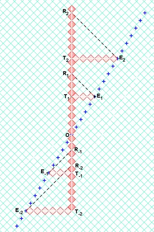

Here's a spacetime diagram that shows a ship (moving with $v=(3/5)c$ in the lab frame) sending periodic signals to the lab frame. Time runs upwards.
I've drawn the diagram using my "rotated graph paper" method so that it is easy to count ticks along segments. The light-clock diamonds are traced out by the light-signals in a light-clock along the timelike diagonal of the diamond. The important feature is that all light-clock diamonds have the same area.
RRGP-robphy-TimeDilation-vs-Doppler
  • You can see the velocity of the ship is $\displaystyle v=\frac{T_1E_1}{OT_1}=(3/5)c$ (count 5 ticks up , then 3 space-ticks ["sticks"] over). By construction (using these numerically-nice numbers), there are 4 diamonds along the ship worldline segment $OE_1$.
    The time dilation factor is $\displaystyle\gamma=\frac{OT_1}{OE_1} =\frac{5}{4}$, which you can check using the formula $\displaystyle\gamma=\frac{1}{\sqrt{1-(v/c)^2}}$.
  • You can see the Doppler factor $\displaystyle k=\frac{OR_1}{OE_1}=2$ when they are separating,
    which you can check using $\displaystyle k=\sqrt{\frac{1+(v/c)}{1-(v/c)}}$ with relative-velocity $v=(3/5)c$.
    You can see the Doppler factor $\displaystyle k=\frac{OR_{-1}}{OE_{-1}}=\frac{1}{2}$ when they are approaching,
    which you can check using $\displaystyle k=\sqrt{\frac{1+(v/c)}{1-(v/c)}}$ with relative-velocity $v=-(3/5)c$.
    In other words, when the ship is emitting with a period of 4-ticks (in the ship frame),
    the lab receives the signals (on the lab-worldline) with period 8-ticks when they are separating [thus, redshift],
    but period 2-ticks when they are approaching [thus, blueshift].
    In both the separating and approaching cases,
    the lab regards (by, say, a radar measurement to determine the events on the lab-worldline are simultaneous with distant events on the ship worldline) the elapsed time between consecutive ship-emission-events to be 5 ticks.

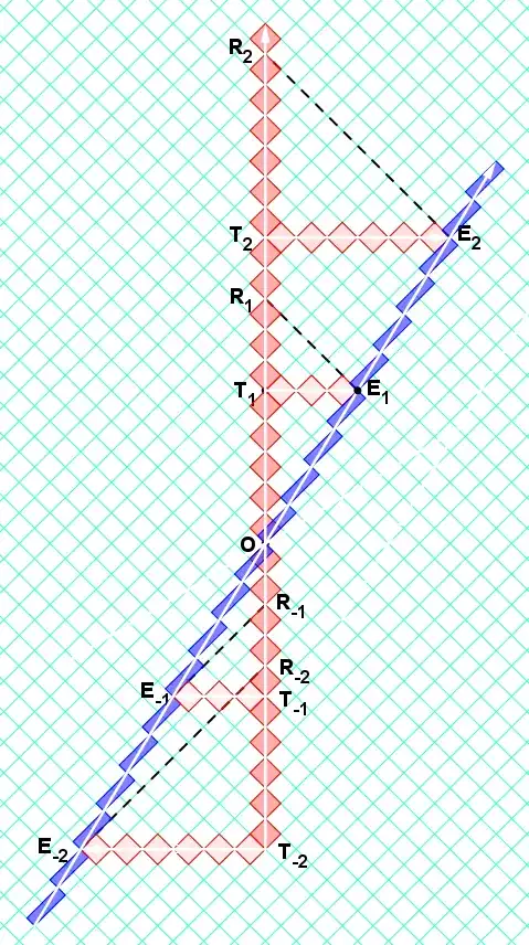

If we turn-off time dilation (assuming absolute time), we get a diagram like this:
RRGP-robphy-TimeDilations-vsDoppler-noTimeDilation
For simplicity, we keep the emission signals the same.
So, now, assuming no time-dilation (pure classical Doppler effect), the emission-period by the ship is now 5 ticks.
  • When they are separating, $\displaystyle k_{classical,sep}=\frac{OR_1}{OE_1}=\frac{8}{5}$,
    which is consistent with $(1+(v/c))$ with $v=(3/5)c$.
  • When they are approaching, $\displaystyle k_{classical,app}=\frac{OR_{-1}}{OE_{-1}}=\frac{2}{5}$,
    which is consistent with $(1+(v/c))$ with $v=-(3/5)c$.
[NOTE: Without time-dilation, this experiment will not be in agreement with the principle of relativity.
Consider light-signals emitted by the lab frame every 5 ticks. When does the ship receive those signals? ]

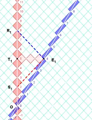

UPDATE to address the OP's question in the comment.
Here's a radar measurement by the lab frame.
  • Wristwatches zeroed when the lab and ship meet at event O.
  • After 2 ticks on the lab-wristwatch (event $S_1$), the lab sends a signal (encoded with "2"), which meets the ship worldline (at $E_1$) and is reflected back to the lab, received when the lab-wristwatch reads 8 ticks.(at $R_1$).
  • Data collected by the lab: $OS_1=2$, $OR_1=8$
  • Data analyzed by the lab: $k=\frac{OE_1}{OS_1}$, $k=\frac{OR_1}{OE_1}$ (with $E_1$ possibly unknown).
    So, $k^2=\frac{OR_1}{OS_1}=\frac{8}{2}=4$. Thus (Doppler Effect) $k=2$, predicting $OE_1=(k)OS_1=4$.
    The lab assigns time-coordinate $OE_t=(OR_1+OS_1)/2=5$ to the event $E_1$.
    The lab assigns space-coordinate $OE_x=(OR_1-OS_1)/2=3$ to the event $E_1$.
    Thus (Time Dilation) $\displaystyle \gamma=\frac{OE_t}{OE_1}=\frac{5}{4}$.
    (We could suppose that when the ship receives the light-signal, it sends its wristwatch reading "4" with the reflection [of the "2" from the lab]. Thus the reception event at the 8th-tick has the original "2-tick" timestamp carried in the light-signal from the lab and possibly the "k*2-tick" timestamp from the light-signal from the ship.)
RRGP-robphy-radar-1

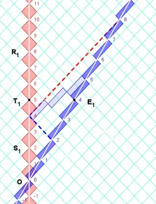

As an exercise, you should carry out an analogous radar measurement done by the ship. Here is the diagram.
RRGP-robphy-radar-2

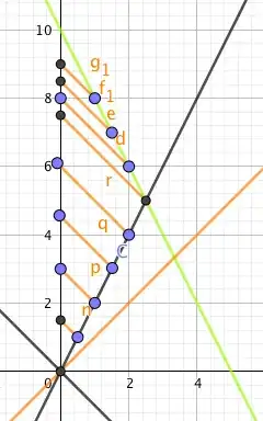

Minkowsky diagram of spaceship wit v=c/2 The best way to illustrate your question is a diagram like here. red is light signal coming from the spacecraft and reaching the stationary earth the outgoing spaceship in blue, returning grenn. You see that earth gets the signal in equal time intervals as they are send in equal time intervals.
