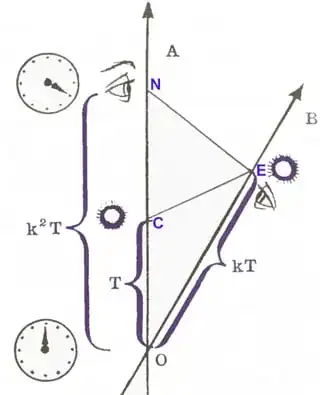

Using graphics based on Bondi's from my article https://www.physicsforums.com/insights/relativity-using-bondi-k-calculus/ on the Bondi k-calculus (which uses the Doppler effect)...
  • In the simplest case, the Doppler effect involves a triangle with two future-timelike sides from the same event, with their tips joined by a light-signal--a TLT-triangle. So, in the diagram below, OCE involves the Doppler effect, where OC is like the "period between transmissions at O and C", CE is a light-signal (OO was a degenerate light-signal) and OE is like the "period between receptions at O and E".
robphy-Bondi-k
The ratio of these timelike legs $k=OE/OC$ is the Doppler factor.
OEN is also a Doppler effect. In fact, OEN and OCE are similar triangles in Minkowski spacetime geometry. [Bondi didn't draw the light signals CE and EN at 45-degrees.]
More generally, in $(1+1)$-Minkowski spacetime, the Doppler factor would involve a trapezoid with parallel lightlike edges, which cuts two timelike rays from a common event. (For instance, use a light-signal parallel to CE and use the intersections of CE with the observer worldlines instead of the degenerate signal OO.)
The Doppler factor $k=\exp\theta$, where $\theta$ is the rapidity (Minkwoski-angle) between inertial worldlines [drawn at event O].

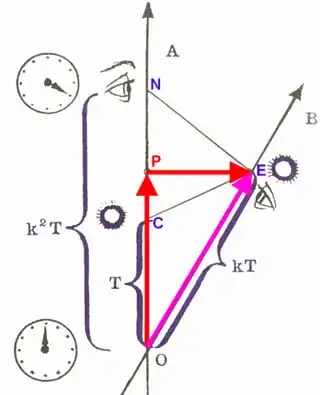

  • The time-dilation effect involves a a Minkowski right-triangle with two timelike sides from the same event, with their tips joined by a spacelike edge which is orthogonal to one of the timelike sides--a TST right-triangle. So, in the diagram below, OPE is a Minkowski right-triangle where OP and PE are orthogonal, with Minkowski-right-angle at P, so that OE is the hypotenuse. According to the observer along OP, events P and E are simultaneous. The OP-observer says that the "elapsed time between O and E [in OP's frame]" is equal to the "elapsed time between O and P [in OP's frame]". Trigonometrically, OP is the projection of the hypotenuse OE onto OP's worldline. In terms of the rapidity $\theta$ between the timelike sides [drawn at O], OP is the adjacent side. So, $OP=OE\cosh\theta$.
robphy-Bondi-gamma
The ratio of these timelike-legs $\gamma=OP/OE$ is the time-dilation factor.
Thus, $\gamma=\cosh\theta$.
The ratio of these orthogonal legs $PE/OP$ is the spatial velocity of OE according to OP.
Thus, $v=\tanh\theta$.
Since Bondi didn't draw the light rays CE and EN along 45-degree angles, it's not obvious that $CP=PN$ (that is, P is the mid-point on CN) and $|CP|=|PN|=|PE|$, where CEN is a radar measurement.
From the Bondi k-calculus viewpoint,
since CEN is a radar measurement where inertial segment CN intersects the light cone of E,
the midpoint of CN (named P) is simultaneous with E, according to the observer along CN.
Thus, PE is Minkowski-orthogonal to CN (and to CP and to PN).
