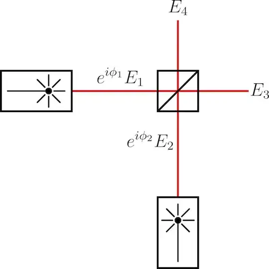

However, there's a problem with this approach, because the two input fields $E_1$ and $E_2$ have a relative phase as they hit the beam-splitter, so the output in mode '3' is actually:
$$ E_3 = \frac{1}{\sqrt{2}} (e^{i\phi_1}E_1 + e^{i(\phi_2+\theta_2)}E_2), $$
where $\phi_1, \phi_2$ are the phases of the input fields on the beam-splitter.
To perform the experiment we therefore first need to measure and fix these phases. But how do we measure optical phases? By interfering the fields! In other words, taking a beam-splitter, combining the two beams and observing the output; when one port is dark the fields are in phase, and when the other port is dark the fields are out of phase. In this type of experiment we can't distinguish between the contribution from the input phase and the contribution from the beam-splitter. Therefore, we simply fix the beam-splitter phase by picking a convention, and then define the optical phase relative to this.
