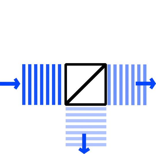

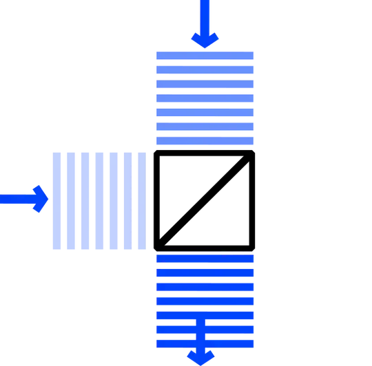

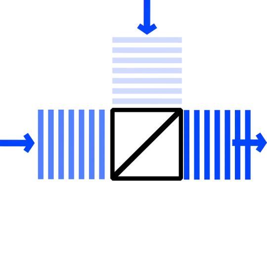

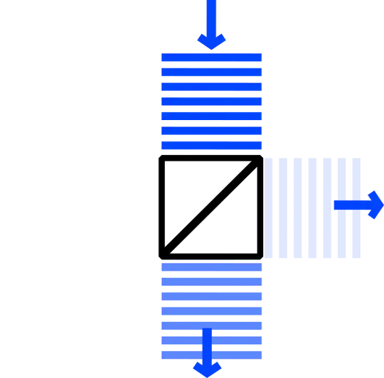

  • First, we are asserting that the EM fields we are willing to consider need to be linear combinations of only two pre-specified modes, which basically look like this:
    $\qquad$
  • Second, we are recognizing that those fields can also be expressed as linear combinations of two modes which look like this,
    $\qquad$
    which are characterized by having all of the output energy on only one of the output ports.
