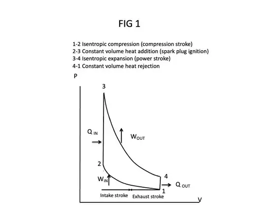

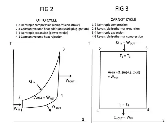

Yes it can be modeled as a heat engine even though, in reality, it is not a heat engine in the strictest sense. Specifically it can be modeled as a reversible Otto cycle where the working fluid is an ideal gas. A PV diagram of the cycle is shown in FIG 1 below. A TS diagram for the cycle is shown in FIG 2. For comparison to an ideal gas Carnot cycle, a TS diagram for it is shown in FIG 3.
A real IC engine is obviously not reversible. But by modeling it as a reversible heat engine cycle one can establish and upper limit to the efficiency of the real engine. (Note: FIG 1 shows the intake and exhaust strokes. They have no effect on the theoretical maximum efficiency of the reversible cycle.)
Comparing FIGs 2 and 3 one can see what limits the efficiency of the reversible Otto cycle compared to the Carnot cycle is that all of the heat added and rejected in the Carnot cycle occurs at fixed temperatures, which maximizes the area enclosed (net work done) in the TS diagram for a given maximum and minimum cycle temperature. For the Otto cycle, the addition and rejection of heat occur over a range of temperatures.
