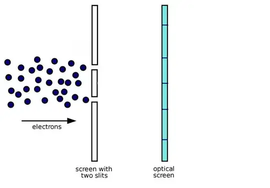

I have seen this answer by "anna v" which states an electron never travels through both slits only one slit per electron and the pattern formed is only a statistical probability distribution for the entire accumulation.
But assuming in an experiment in which electrons travel one after the other and each electron travels only through one slit then how could the pattern on the screen be different from the one when we close one slit interchangeably and send electrons only through one slit at a time. (Actual experiments have shown patterns are different indeed)

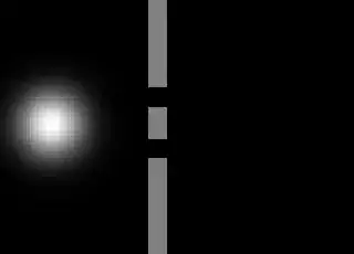

I think an electron through double-slit as a superposition of probabilities of spatial distribution. Like this picture below:
But according to anna v picture that come to my mind is below (several electrons illustrated):

In general, a different pattern of slits in a single particle interference experiment will result in a different pattern of fringes at the end of the experiment. Consider a point P on the screen that is lit when there is one slit and is dark when there are two slits. If there was one slit an electron might be detected at P, but with two slits the electron won't be detected at P. And if you subject the region after the slit to an electric or magnetic field in general that will change the pattern of fringes. That's not a matter on which physicists disagree, but there is disagreement on what is happening in reality to produce that outcome, or whether such an account is required.
If somebody doesn't have an account of what is happening in the experiment, then they have no account of what is happening in the experiment. So then how could they say whether the experiment has been conducted correctly? If there is no account of what's happening in the experiment, then what is the standard by which the correctness of the setup is judged and what is the explanation for why you adjust the experiment in a particular way to improve it? So we can and should discard the idea that it's acceptable to have no explanation of what's happening in the experiment.
What is the explanation?
The only idea that I think actually works goes like this. The pattern changes if you introduce a second slit, so there must be something coming through the second slit that prevents the electron from arriving at P and that thing is blocked by substances that block electrons, i.e. - the material of the screen. Whatever the thing is that's coming through the second slit it will be affected by magnets and electric fields, just as an electron would be. So it's something that acts like an electron except that we don't detect it. This electron can only be blocked by a portion of a screen or a detector if it interacts with it, but we don't see the result of that interaction, so it must be interacting with an screen or detector that we don't see. That "invisible" screen or detector must have been put there by somebody, so there are "invisible" people too and it must have been manufactured by a factory and so on. There are entire universes full of "invisible" stuff that only interacts with the universe we see around us in such a way that we can exclude other explanations under some limited conditions in labs. And that is what quantum mechanics implies about the world too. This way of looking at quantum mechanics is often called the Everett interpretation, but nobody has proposed another account of what's happening in single particle interference or other quantum mechanical experiments. For more details see "The Fabric of Reality" by David Deutsch and

  1. Is stating whether the electron passes through both slits or it only passes through one slit just a personal opinion/interpretation that cannot be proven or disproven by observations?
Yes
  1. Is the so-called wave nature of particles only a mathematical model or is there some physical nature (properties) to the probabilistic wave that passes through the double slit?
This question is difficult to give a proper answer. The correct course of action is to identify the unequivocal current best theory and the thing they are meant to explain, and so then the mathematical description is exactly the physical reality. i.e. the wavefunction of the single electron in an empty universe is exactly the physical electron itself. Needless to say, this is somewhat interpretation dependent and also hotly debated.
In the double slit experiment, electrons and photons essentially behave the same way, so we can just state it as a general thing for all quantum particles. What we can really conclude from the experiments are that
The excitation in quantum fields get detected like particles but moves like waves.
It is necessary to have some wave parts, because the only way for the isolated single excitations, one-by-one passing through the slits and having interference patterns emerge, the whole "one electron/photon at a time", requires that the wave parts pass through both slits at once. Plenty of people insist that this wave part is not the single electron/photon, but they will not likely disagree that there is this wave part that passes through both. It thus comes down to whether one chooses to include the wave part with the particle part or not. Lots of arguing, very little sense.
There is this little book on some philosophical foundations of quantum theory, and in it, the author covered the fact that you could choose between "the particle passed through slit A AND slit B" and "the particle passed through slit A OR slit B", because as long as you are consistent, these two alternatives are both allowed by quantum theory. I am still searching for the book, though.
Instead, the better argument to have, is to consider that we really ought to stop using the wave-particle concept. Instead, what we have are quantum fields, and what we consider to be waves or particles, are really just excitations on these quantum fields. In that sense, both the wave aspects and the particle aspects come together, and we would sidestep all of these silly arguments.
It is actually rather bad to not include some interpretations business when answering this question. The de Broglie Bohm Pilot Wave Interpretation is rather illuminating here, because if you work out the actual trajectories of a hidden particle riding along the guiding wave, the wave part goes through both slits and causes the interference pattern, but the particle only ever passes through one slit. It is then a very curious thing that the trajectories are separated by the symmetry centre line. That is, it is only after quite a lot of work into Pilot Waves, did we discover that a particle that passes through the bottom slit, will appear on the bottom half of the screen, and never on the top half, and vice versa. It is obvious upon hindsight that such things can occur, but otherwise completely non-trivial.
Alas, that is completely interpretation dependent, and bringing it up is not an endorsement of Pilot Wave Interpretation. It is just fun to consider that there are such interesting things.
A helpful fact that few physicists will disagree with is that the wavefunction of the electron certainly goes through both slits. Also, personally I think that describing the whole wavefunction of the electron sufficiently describes that electron.
The origional and simplest model of QM models the electron as follows:
When the electron is not being measured, a "wavefunction" (which moves similarly to a wave) propagates in space. This wave can interfere with itself just like how a wave of water can split into smaller waves and interfere with itself. When the electron is measured, the probability of finding the electron is proportional with how high that wave is at the point in space that wave is located at.
Because the wave is associated with probability of seeing the electron at a specific spot, it's not as if the wave-itself can be seen. Furthermore, because the electron is not seen when it is traveling (since measuring it would stop this wave from existing), we cannot make statements easily about what is happening when it is traveling.
Ultimately though, there is a lot of good conceptual intuition that the electron is going through "Both" slits, simply because it behaves in a way that is different than if it had simply went through either one or the other.
"But assuming in an experiment in which electrons travel one after the other and each electron travels only through one slit then how could the pattern on the screen be different from the one when we close one slit interchangeably and send electrons only through one slit at a time. (Actual experiments have shown patterns are different indeed)"
Even if we do not understand the details, we know that the reason for the observed pattern is the electromagnetic interaction between the electrons and the barrier. We also know that the forces acting on the electron depend on the distribution of charges (the electrons and nuclei in the barrier). So, it is to be expected that if the charge distribution changes (by adding/removing a slit) the EM force acting on the electron changes as well, leading to a different pattern. I see nothing remarkable/unexpected about that.
Of course, in order to get a detailed understanding one needs to actually simulate the electron/barrier interaction. Unfortunately, due to the large number of charges involved, such a calculation is not possible at this time.
"Is the so-called wave nature of particles only a mathematical model or is there some physical nature (properties) to the probabilistic wave that passes through the double slit?"
I think it is only a mathematical model, otherwise, the collapse of the wave to one point would imply faster than light effects which are unlikely.
"Is stating whether the electron passes through both slits or it only passes through one slit just a personal opinion/interpretation that cannot be proven or disproven by observations?"
Same as above, we have good evidence that nature is local, therefore any explanation that requires non-local effects is unlikely.
