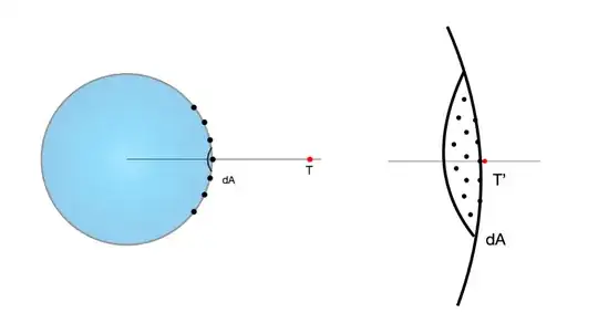

[EDITED] I understand how Electric Field and Potential ( E and V ) can be calculated inside and outside a spherical conductor at electrical equilibrium using Gauss law, but I have a doubt when trying to find E exactly on the surface where charges are distributed: in this case, Gauss law seems to fight with Coulomb law. Given a test charge of 1 Coulomb very little like a point (a "test" charge) we try to calculate the force on it when moving from T to T'. Assuming E as the force exerted by charges on the surface on the test charge of 1 Coulomb, according to Coulomb force it should be undefined ( E is inversely proportional to the distance by the effective charges on the surface and the test charge, but the distance is zero ). There is a unit of charge (an atom without an electron) very close to the test charge. I know I have to imagine all the charges on the center of the sphere, but in "real life" charge is composed by units (e.g electrons) distributed on the surface. Why the test charge does not feel the force exerted by those units when approaching to the surface going to "infinite"? Further, considering a patch of charge on the surface (dA), why it "goes" to zero when the test charge goes to the surface ( making zero also $(\sigma\,\mathrm dA)$ )?

Anyway, let us get back to your problem. Your problem stems from dealing with point charges and spread-out charges at the same time. Yes, per Coulomb's law, there is a distance-of-zero based singularity as the test charge passes through the surface charges. But this distance-of-zero singularity goes as $$\left|\vec F\right|=\frac1{4\pi\epsilon_0}\frac{q(\sigma\,\mathrm dA)}{r^2}$$ and so it goes to zero with $\mathrm dA$
So, something else must help us decide the $\frac00$ that is happening, and the conceptual understanding we need to add is that we want the forces behave exactly as the spherical field should do. This way, we pick that there will be no weirdness as the test charge passes through the sphere.
This is true when approaching a point charge, where a non-zero charge is concentrated in a single geometrical point.
But the charge on the sphere's surface is not a point charge, it is distributed. It a sheet charge density, spread evenly over the surface (at least in classical electrostatics where we ignore the quantization of charge). The total charge on a patch of the surface goes to zero as the size of the patch goes to zero.
Therefore the surface charge "at distance 0" from the test charge is actually 0, and you have to do some calculus (or at least, some reasoning from Gauss's Law) to work out the total field due to the distributed surface charge.
