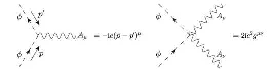

I have a question that I'm struggling to solve. Here is the background: In scalar QED, the electron is replaced by a charged scalar particle $\phi$, and its corresponding antiparticle $\phi^{*}$, which couple to the photon through the following interaction vertices.
Vertex Feynman rules
I've been trying to calculate the differential cross section $\frac{d\sigma}{d\cos \theta}$ for the process $\phi \phi^* \to \phi \phi^*$, in the centre of mass frame.
In my attempt to solve this, I read about toy theory in David Griffiths' particle physics book, which is a simplified version of QED where one can disregard spin. I was thinking that this might be the way to go in order calculate the differential cross section, but I might also be wrong.
Question: Calculate the differential cross section $\frac{d\sigma}{d\cos \phi}$ for the scattering process $\phi \phi^{*}\to\phi \phi^{*}$ in the centre of mass frame, to lowest order in $e$.

We have two tree level diagrams in 2'nd order of e, these are identical to the Bhabha-scattering diagrams, but with fermions exchanged for charged scalars, see Bhabha scattering for reference. You can figure out which feynman diagrams are possible for a given reaction by checking which combinations of vertices produce it.
The simplest "how to" I can give for getting the amplitude from a diagram is that you simply multiply together the contributions from the different parts of the diagram in order, e.g. in our annihilation case we have:
(outgoing $\phi$)(outgoing $\phi^*$)(vertex)(photon propagator)(vertex)(incoming $\phi$)(incoming $\phi^*$)
Where the propagator is : \begin{align} i\mathcal{D}_{ab} &= \frac{i\eta_{ab}}{(k)^2} \end{align} in the t'hooft gauge, and the ingoing and outgoing particles each contribute a multiplicative 1. Note that how the particles relate to the vertex is given by the lagrangian and is not generally (particle 1)(particle 2)(vertex).
We then get that the diagrams have the amplitudes:
\begin{align} i\mathcal{M}_1 &= (-ie(p-q)^a)\frac{i\eta_{ab}}{(p+q)^2}(-ie(p'-q')^b)=-ie^2\frac{(p-q)_a(p'-q')^a}{(p+q)^2} = -i2e^2\frac{p_a p'^a -p_aq'^a}{(p+q)^2}\\ i\mathcal{M}_2 &= (-ie(p-p')^a)\frac{i\eta_{ab}}{(p-p')^2}(-ie(q'-q)^b)= -i2e^2\frac{p_a q'^a -p_aq^a}{(p-p')^2}\\ i\mathcal{M}&=i\mathcal{M}_1+i\mathcal{M}_2 = -i2e^2(\frac{p_a p'^a -p_aq'^a}{(p+q)^2}+\frac{p_a q'^a -p_aq^a}{(p-p')^2}) \end{align}
