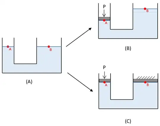

  • This is an old post, but after a recent notification I've delved into this topic again. The key here is to look at the definition when it says "all points":
    Pascal's Law (also called Pascal's Principle) says that "changes in pressure at any point in an enclosed fluid at rest are transmitted undiminished to all points in the fluid and act in all directions."
    Now let's look at the following figure. In (A) we simply have the fluid "resting". Assume that point A and B pressures are zero, i.e., in "vacuum". If you apply a force in point A to change the pressure at that point to be $P$ using e.g. a piston, the fluid will move upwards in point B, until a liquid column is created such that the pressure generated by its height makes the system static again (situation (B)). In this case we can see that point B pressure remains zero since it's only exposed to vacuum.
On the other hand, as depicted in situation (C), if you placed a piston at point B and then make it fixed, you would see that the increment of pressure, $P$, in point A would transmit that pressure undiminished to point B (you could test this: if instead of fixing the piston you held it yourself, you would notice that a counter pressure $P$ would be required to be applied in point B to keep the system static).
In summary, it is not true that a change in pressure at any point (e.g. point A) in an open fluid system at rest is transmitted undiminished to all points (e.g. point B).
In response to Babou: You could argue that instead of the fixed piston you would add a liquid column yourself, but that is something external to the fluid system we are analyzing, like the piston at B. Remember that the principle applies to the fluid itself and not the hypothetical external objects you use.

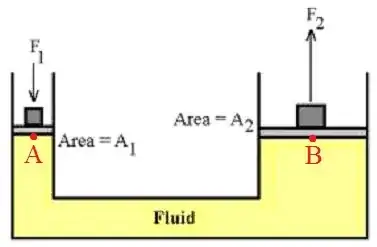

Pascal used a syringe that allowed leakage of fluid, to demonstrate that increasing pressure at one point would increase pressure at all points. Although water is leaking, as Babou said, we can still consider the fluid enclosed, where, instead of holes (that allow leakage) we could use sensors to mesure pressure.
Syringe
(source: ucla.edu)
Watch a Wolfram demonstration of the syringe here
It is useful to assume the container must be leak-proof. Why? If fluid left the container while changing pressure in point A (for example pressing the piston) then the heights between point A and B would be different and they must be equal in order to prove that pressure on A and B are equal and then proving that by raising pressure on one of the points then the pressure on the other point will raise equally.
This is because $\Delta{p} = \rho g \Delta z $ (you can see in this document how to derive this formula). If the difference between the heights are zero ($\Delta z = 0$) then $\Delta p = 0$ thus we conclude $p_A = p_B $.Now we can visualize that if I double the pressure on A then I also double the pressure on B, meaning the pressure was indeed transmitted through the tube.
