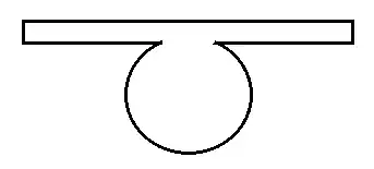

The picture is a cross-section image of a container that will cool faster when it is full than when it is half-full. It consists of a large disk on top of a sphere, with the same volume so that only the sphere contains liquid when it is half-full. The opening between them is large so that heat can flow easily between the two parts when it is full.
weird container composed of a flat hollow disk atop a sphere with equal content
Clearly, the disk has a very large surface to volume ratio and will act effectively as a radiator to cool the liquid it contains, while the shere has the smallest possible ratio and will not cool fast. However, when the container is full, heat will flow through the liquid from the sphere to the disk so that all the liquid content will cool rather fast, though the disk will get cooler faster than the sphere.
If the container is only half-full, only the sphere contains warm liquid, with a small surface/volume ratio. Hence it will cool more slowly.
If the container is large enough, this should be sufficient.
It can be improved by remarking that a horizontal disk shape is not very good for convection heat transfer. Replacing the hollow disk with an inverted bell shape would work better.
You can even reinforce further the effect by using for the side of the container a material that is more heat conductive transversally than laterally, so that heat goes out quickly but is not conducted efficiently from one part of the container side to another. That avoids heat being transferred to the disk when the container is half full, and still permits the disk to cool efficiently the liquid it contains when full. It can be easily produced by using a heat insulating material with copper nails piercing it at close regular intervals.
The same effect could be achieved with a bottle having a standard shape, but with isolation only in the bottom part. This is somewhat close to what I said about the effect of a conductive cork in the thermos case.
