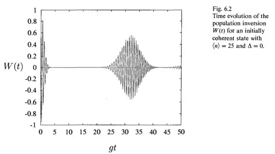

Rabi oscillations can probe the "quantumness" of the electromagnetic field. Quantized fields interacting with two-level systems can lead to collapses and revivals in Rabi oscillations. This is a pure quantum effect. Any textbook on quantum optics will explain this phenomenon. This is how they look like [from Quantum Optics, by M. Scully and M. Zubairy] Collapse and revivals of Rabi oscillations
