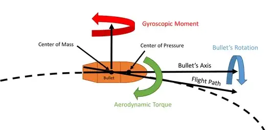

  1. Bullet spin causes a bullet to become a gyroscope. Specifically, bullets have their center of pressure in front of their center of mass. Therefore, when pressed, gyroscopic forces cause a bullet to spin 90 degrees instead of tumble. See this diagram:

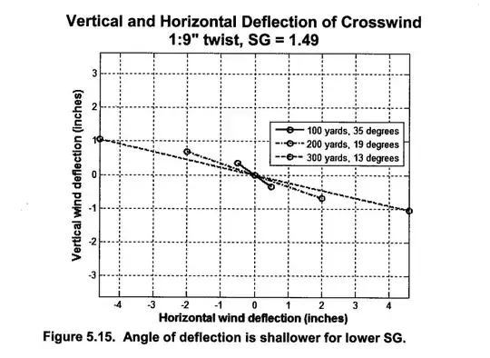

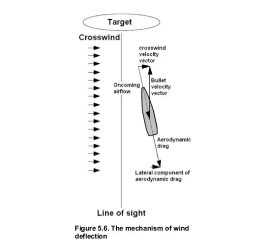

  1. The precession does not cause the bullet to point into the direction of movement, but the direction of apparent incoming wind. That means that if there is a crosswind of 20mph, the bullet will turn slightly to point towards the incoming wind while traveling straight forward. See this diagram:

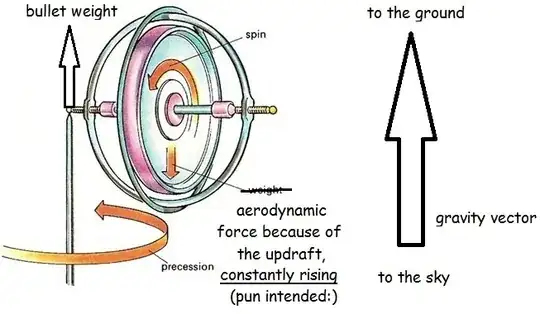

3a) As a bullet drops, there is apparent wind coming from the downward direction. Apparent wind occurs when there is a differential between the object and the surrounding medium. Therefore, the bullet turns down as it drops. See this diagram below.
3b) Importantly, gravity accelerates, so there is always an increasing apparent wind as the bullet falls. This accelerating vertical apparent wind causes continuous forward rotation of the bullet.
4a) Air resistance forces to the front of the bullet and those to the side of the bullet cause different behavior. Air resistance to the front causes the bullet to reorient into the direction of the incoming force. (See the first image.)
4b)Air resistance to the side of the bullet (i.e., from the left, up, down, or right directions) pushes the bullet to point 90 degrees clockwise to the incoming air. So left-to-right crosswind cause aerodynamic jump down and a or right-to-left crosswind causes aerodynamic jump up. (Note the horizontal defection in this image is due to the crosswind, which is distinct from spin drift.) See this diagram:

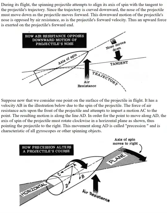

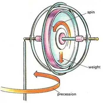

  1. Therefore, intuitively, when a bullet rotates down due to being in a falling trajectory with gravity, it points to the right if it has a right-hand twist:
  1. But every diagram I see of a gyroscope has the gyroscope rotating the opposite direction.

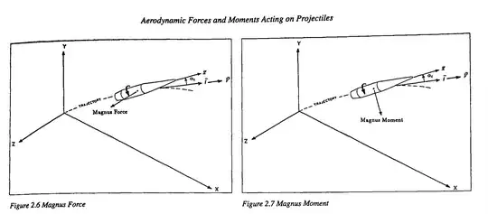

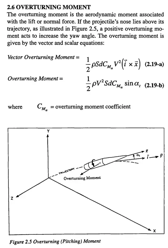

  1. I can’t figure out why the bullet gyroscope rotates in the opposite direction of other gyroscopes. This is not Magnus effect! From Modern Exterior Ballistics, McCoy, “Although the Magnus force acting on a spinning projectile is usually small enough to be neglected, the Magnus moment must always be considered.” Note in the diagram that the Magnus moment points down, and not the to left or right. See these diagrams:
  1. In contrast, spin drift is related to the pitching moment, which does point left or right. See this diagram:

About gyroscopic precession: there is a 2012 answer by me in which I present an explanation of gyroscopic precession using diagrams. (In that explanation I do not use the angular momentum vector. Instead the explanation takes advantage of symmetry.)
I won't repeat that explanation here; to give you an idea: the space in which the gyro wheel is rotating is divided in 4 quadrants that are not co-rotating with the gyro wheel. The explanation tracks the motion of sections of the gyro wheel as those sections of the gyro wheel are moving through the quadrants.
I verified with my gyroscope:
When as seen from my perspective the gyro wheel is turning clockwise, and I pitch nose down, then the gyro wheel turns to the left. (And it follows of course that when rotating counterclockwise as seen from my perspective a nose down pitching will have the gyro wheel turning to the right.

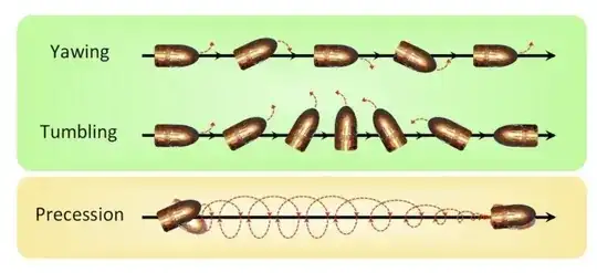

According to the description you copied: after the bullet exits the muzzle the bullet quickly developes a motion pattern where the spin axis of the bullet is sweeping out a cone. According to the description: over time the amplitude of that cone becomes smaller.
According to the description: for the pitch angle there is an 'angle of repose'. The bullet tends to settle onto that angle of repose. (According to the description: a cross wind will tend to mess with that.)
I emphasize: this 'angle of repose' is a dynamic state that the bullet tends to settle on, it is not an instantaneous thing.
According to the description there is also a 'yaw of repose'.
This is important: in external ballistics one must be aware of the distinction between 'response to pitching motion' which is instantaneous gyroscopic effect, and 'yaw of repose' which is analogous to the angle of repose of pitching motion of the bullet.
I get the impression that you are totally overlooking that distinction.

I think the following property is essential: when a (spin stabilized) bullet in flight starts to precess then that precessing motion leads to a turbulence pattern that tends to dissipate the energy of the precessing motion.
As an aside, let me discuss a particularly simple example of energy dissipation: a bowl with a marble in it, rolling back and forth. The moving marble experiences air friction, so it is losing velocity all the time. Whatever the initial motion pattern, the motion will become smaller and smaller, and eventually the marble ends up motionless at the bottom of the bowl.
In the case of a bullet in flight and turbulence:
So the observation is that if a bullet in flight experiences a cross wind the orientiation of the bullet tends to change, and the bullet tends to end up in such an orientation that it no longer experiences a cross wind. In effect: the bullet-in-flight has a tendency to turn into the wind.
The essential factor, it seems to me, is that once the bullet is moving into the wind it no longer has opportunity to dissipate energy through precession induced turbulence.
So the fact that the bullet tends to turn into the wind is inevitable, just as inevitable as the marble ending up at the bottom of the bowl.

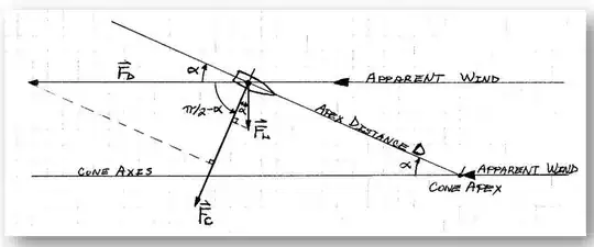

...It looks like precession (the conical movement of the main spin axis) does not start immediately, so while it speeds up to compensate aerodynamic force, the mentioned "bullet drift" is quietly (mentioned by you, but not explained well in books, huh) somehow occurring.

In the context of ballistics, lift is also called the overturning force. As a bullet travels, the bullet naturally does not point straight into the air; it is always slightly eschew. Therefore, one side of the bullet it hit harder by the air and receives more force. This force differential between the top and bottom, combined with the fact that the center of pressure is in front of the center of mass, leads to an overturning torque on the bullet would cause the bullet to overturn and tumble if not for spin stabilization.
